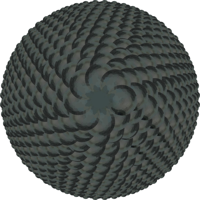

Pretty darn cool jontait2. :)

 Post subject: Re: Replicate-in-rings
PostPosted: Fri Apr 10, 2015 2:01 am  (#13)
Posts: 12836
I like it OMG. Anyway, why not another one. :)

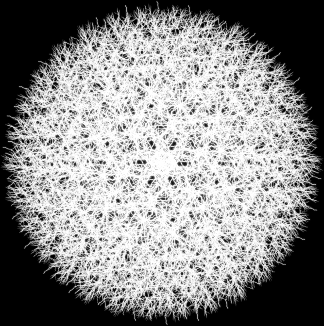

PostPosted: Fri Apr 10, 2015 2:19 am  (#14)
Posts: 12836
Used a rotate n-copy lightening brush for the dandelion. :)
