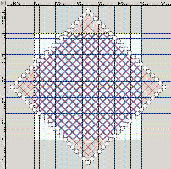

guides_to_path.scm [5.51 KiB]

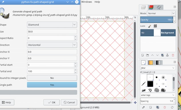

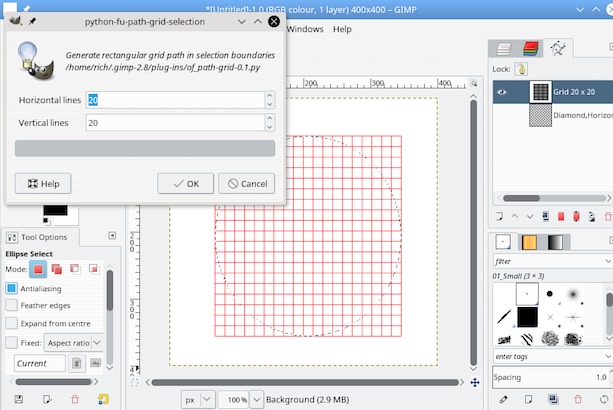

There are as well, from ofnuts
http://sourceforge.net/projects/gimp-pa ... s/scripts/
A plugin for a shaped grid, diamonds, hexagons, etc. path-shaped-grid-0.0.py
A plugin for a grid bounded by a selection path-grid-0.1.py
