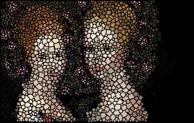

me too, I like G'MIC Shapeism
an attempt

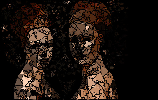

...or this one
