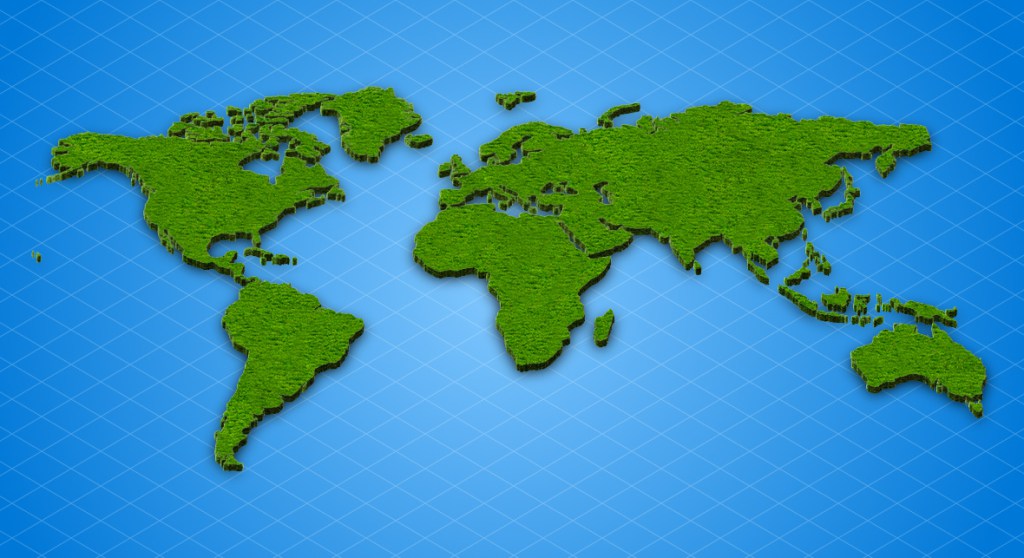

Good afternoon. Over the past few weeks decided to take up the study of Script-Fu to create your own scripts (actions, plugins, whatever you want). Based on the 3D extrusion script, wanted to share the results. The script allows you to create bulk cards. Currently the archive includes: the script, 8 textures and brush 51 different subjects. You can free download the script from my website.
If interest in the project will be the development of the script will continue. And while offering to see with screenshots of the results. The combination of the script and work with your hands give a very good result.

I like that. Makes me want to build an RPG like Civilization. If I knew how to make games.
How did you make the clouds in the first picture?
Use the brush of the cloud, look for it in the package, called 3D-map-clouds

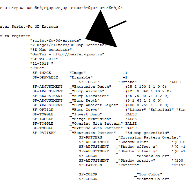

Hello,
the script can not use the script
to: use 3d extrusion.scm together.
This creates a problem with the gimp registry.
Regards Hardy

Hello,
I looked at the script and the code "script-fu 3d extrude"
"script-fu 3d extrude2" changed from to. Now both scripts
work simultaneously.
You have to change all Codes(Three)
Regards Hardy

hardy111 wrote:
Hello,
Regards Hardy
I had changed mine to script-fu-3d-map :) That seemed more appropriate.
But i only needed to change two instances.
define and register code blocks
