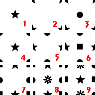

A quick seamless-helper to make it easy to draw seamless textures. After installation it adds three entries in "Layer/Swap" so that the layer you work on has its four quadrants, or right/left sides, or top/bottom swapped so that you can work on the "seams" easily...
For instance:
  • Draw on the center (1)
  • Then use the script to swap center and corners (2)
  • Draw again on the center (3)
  • Swap again (4)
  • Swap left/right to work on the vertical seam (5,6)
  • Swap left/right again, and swap top/down to do the horizontal seam (7,8)
  • Swap top down again: finished (9)

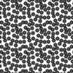

Test:
