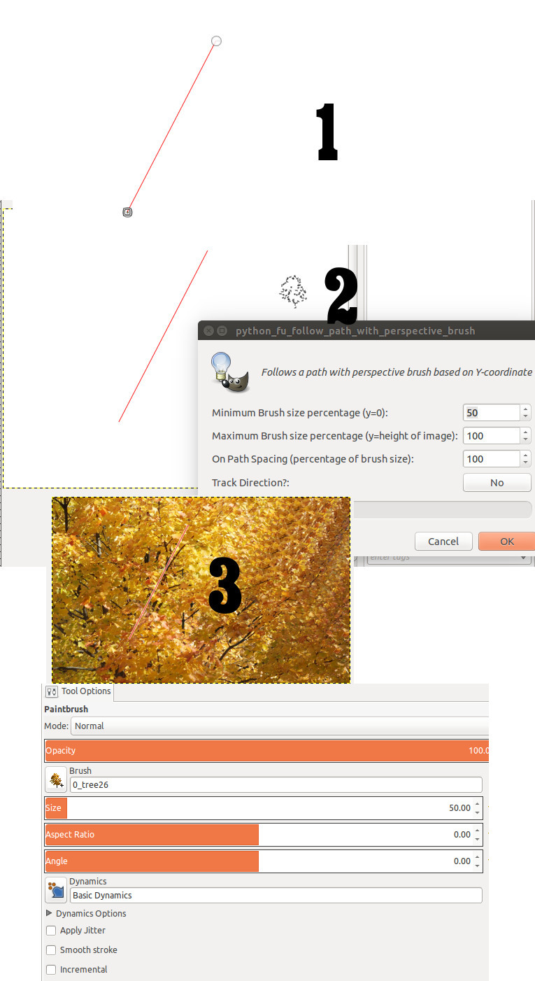

I have tried two versions but I get the same result. First tried 5th and then removed and installed 3rd version. I am attaching screenshots of the process.

Posts: 4561
what is your brush?
it looks small on image 2 but how does it even fill the whole image in 3 it looks like.
It should only brush along the path.

PostPosted: Thu Nov 03, 2016 1:21 am  (#9)
Joined: Dec 29, 2015
Posts: 223
I have changed the brush but no perspective change.
 Post subject: Re: Follow Path With Perspective Brush for GIMP
PostPosted: Thu Nov 03, 2016 1:32 am  (#10)
Posts: 4561
I don't know what's the problem could be.
You're using GIMP 2.8 right?
I remember long time ago I wrote a script in scheme (I think it was the Green Apple Script), where i tried setting the context's brush attributes such as size and it didn't seem to do anything, i had to create a new brush myself in order for script to work.
But i am using 2.8 now and setting the context's set brush size works fine now.
So i am wondering if you might be using an older GIMP.
Other than that possibility I don't know why is isn't working for you.
