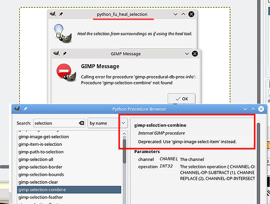

Plenty of the most used plugins, in theory should be re-written even for Gimp 2.8
example heal-selection
run Gimp with compatibility off
gimp --pdb-compat-mode=off
and you get an error even in Gimp 2.8. Development 2.9 versions certainly.
I suspect that even Gimp 2.10 when it arrives will come with compatibility=on.

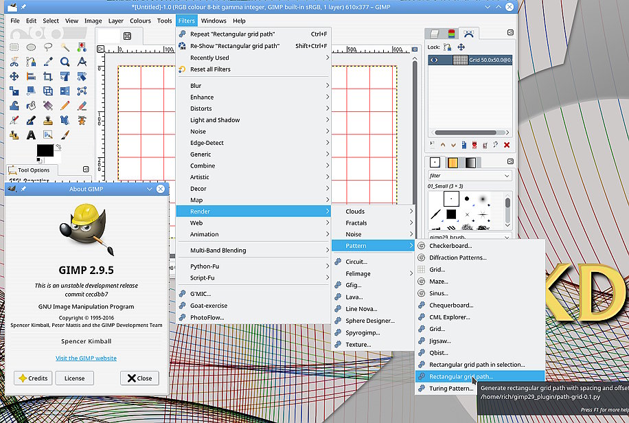

Hi Ofnuts.
Can you put the code on how to properly use "Test the gimp.version" for example, Your plugin:
path-grid-0.1.py
https://sourceforge.net/projects/gimp-path-tools/files/scripts/
In GIMP 2.9.5:
called deprecated procedure 'gimp-image-add-vectors'.It should call 'gimp-image-insert-vectors' instead!
In line 64 and 100 changed
from:
pdb.gimp_image_add_vectors(self.image, self.path, 0)
to:
pdb.gimp_image_insert_vectors(self.image, self.path, None, 0)

Posts: 2613
Hi MareroQ
I think PKHG missed the point of the post about compatibility.
Yes, Gimp 2.9.5 will fail on many scripts and plugins due to changes in the python syntax
but
Run (or compile) gimp 2.9 with compatibility mode ON "--pdb-compat-mode=on"
Should they be re-writtten if possible, of course they should. In the meantime Gimp 2.9.5 is a great tool and really fun to use.
