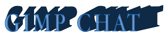

After feathering the selections i created from each path by 5 i get less jaggies. Then i ran unsharp mask on the two filled and then merged layers.

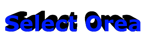

It's flawed right now as you could probably see my question in the forum :hehe

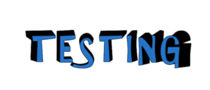

Results with the new plug-in, ofnuts envelope:
Without any touch-ups or gradients:

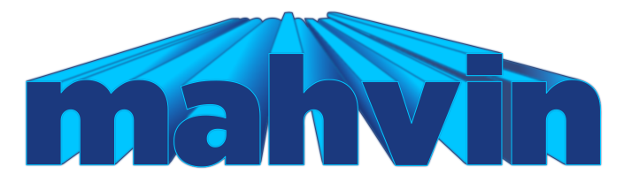

Mahvin, you are producing the exact results I've been striving to achieve for some while, would you mind explaining what "touch up" steps you took please?
 Post subject: Re: Select Area Between Paths for GIMP (for Mahvin)
PostPosted: Sun Nov 06, 2016 5:44 pm  (#13)
RJKD:
Once you have the selected area BETWEEN paths filled with a solid color, and then the front facing font selection filled, just take the paintbrush at 2px and run lines along the peaks and valleys, front to back. Then using the select by color tool (or fuzzy select tool) select each section and fill with gradient. It's a bit tricky getting the gradient to run as you known it should (lighting and shadows). There are other ways to obtain similar results (painting with gradient set at certain brush sizes, etc.) that might be a bit quicker. I'll try experimenting with other techniques to see what works best and fastest.
