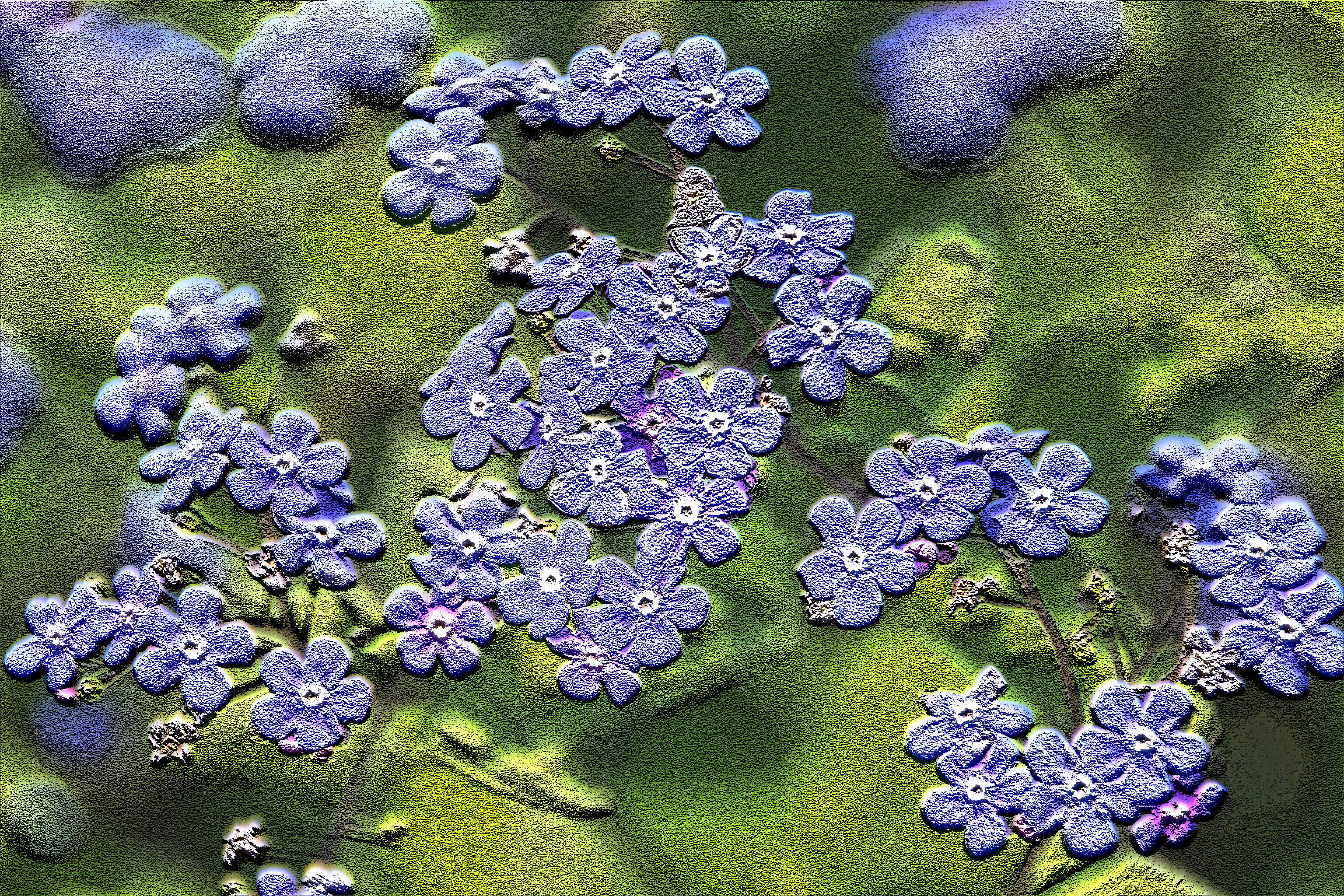

Top at 1.0 setting (strong for this photo, it can be lowered down to .1)
Mid at 6.0
Bottom at 100 with color washed

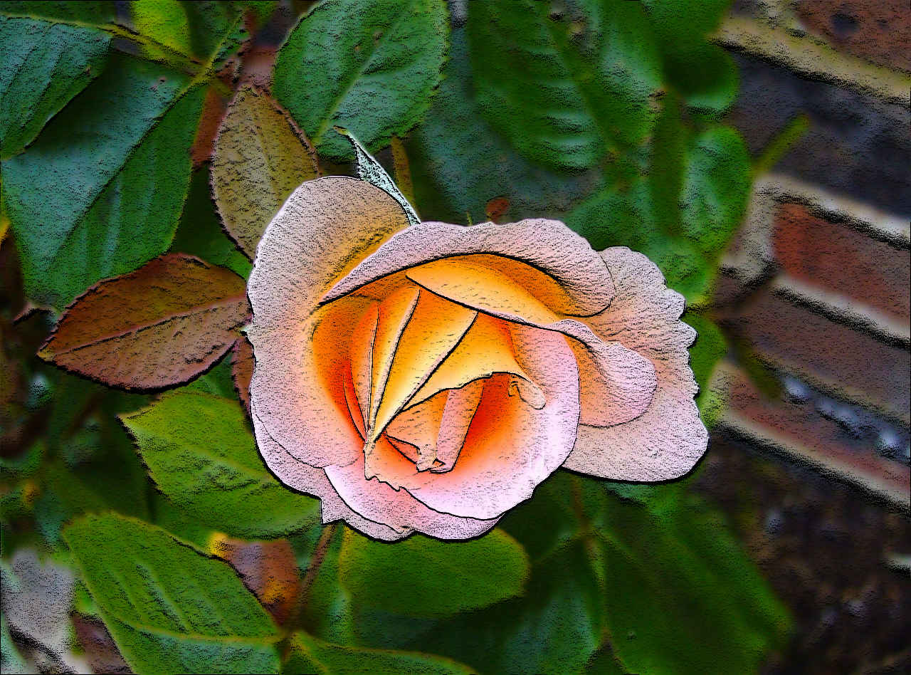

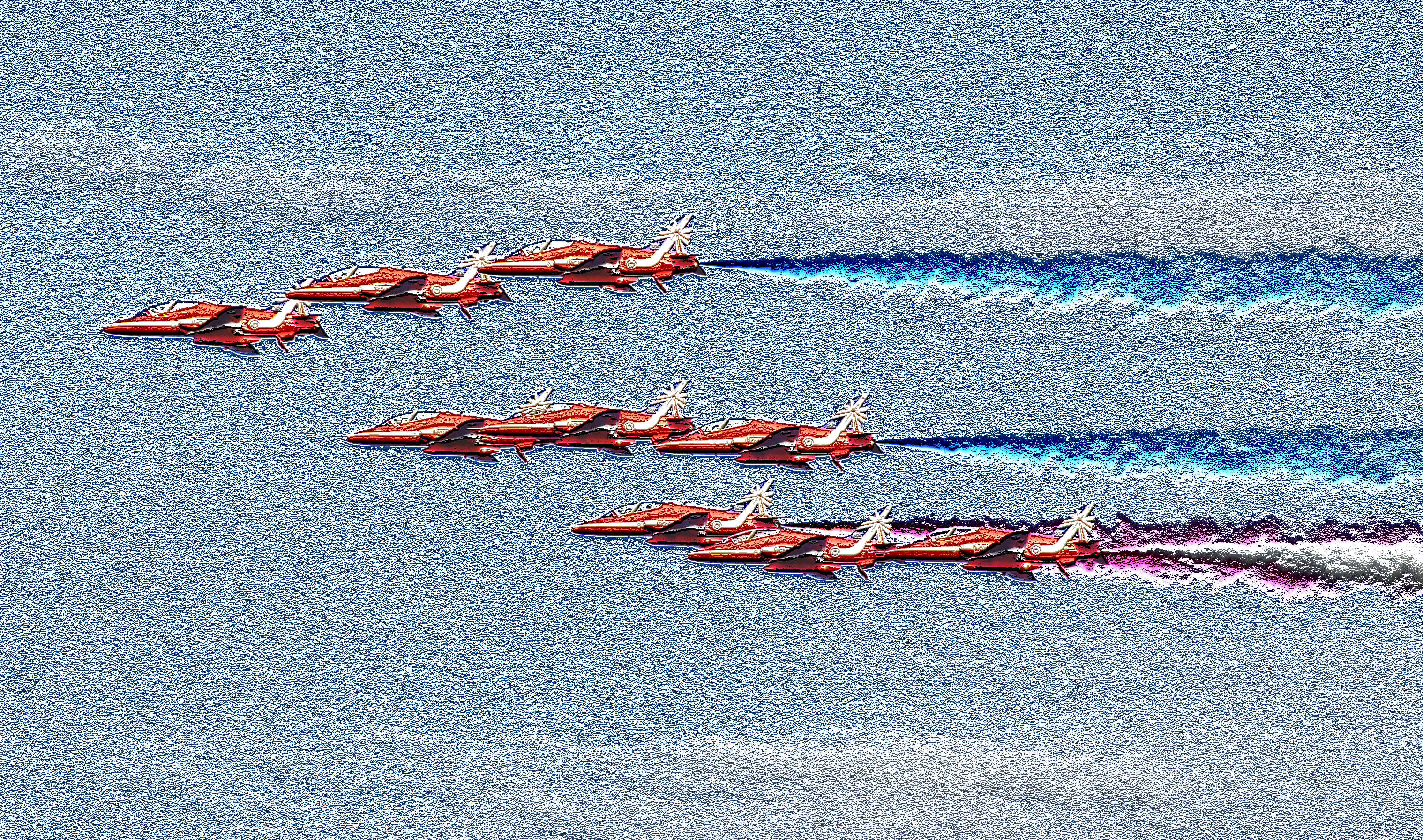

Here are a couple of stong examples

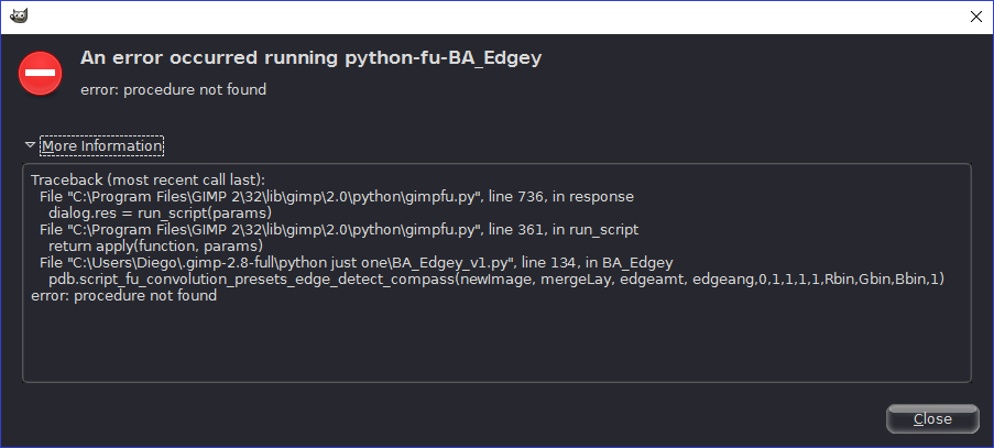

it seems there is a prerequisite

I did not realize that the convolution was from GIMP FX-Foundry.
Thank you Dinasset!

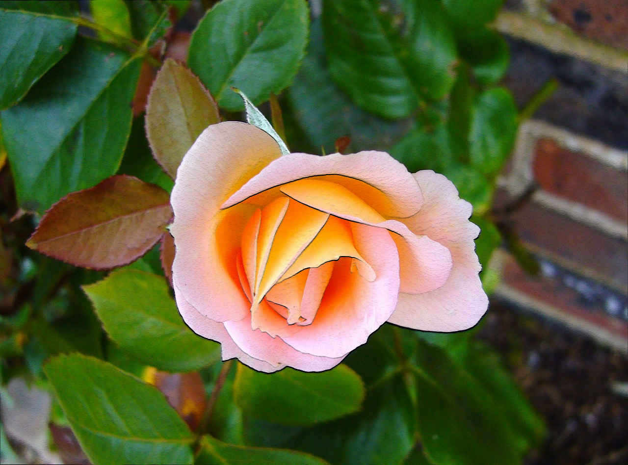

It seems that using defaults, the outcome on a figurative image is not nice (at least to my taste)
original
could you double-check?
