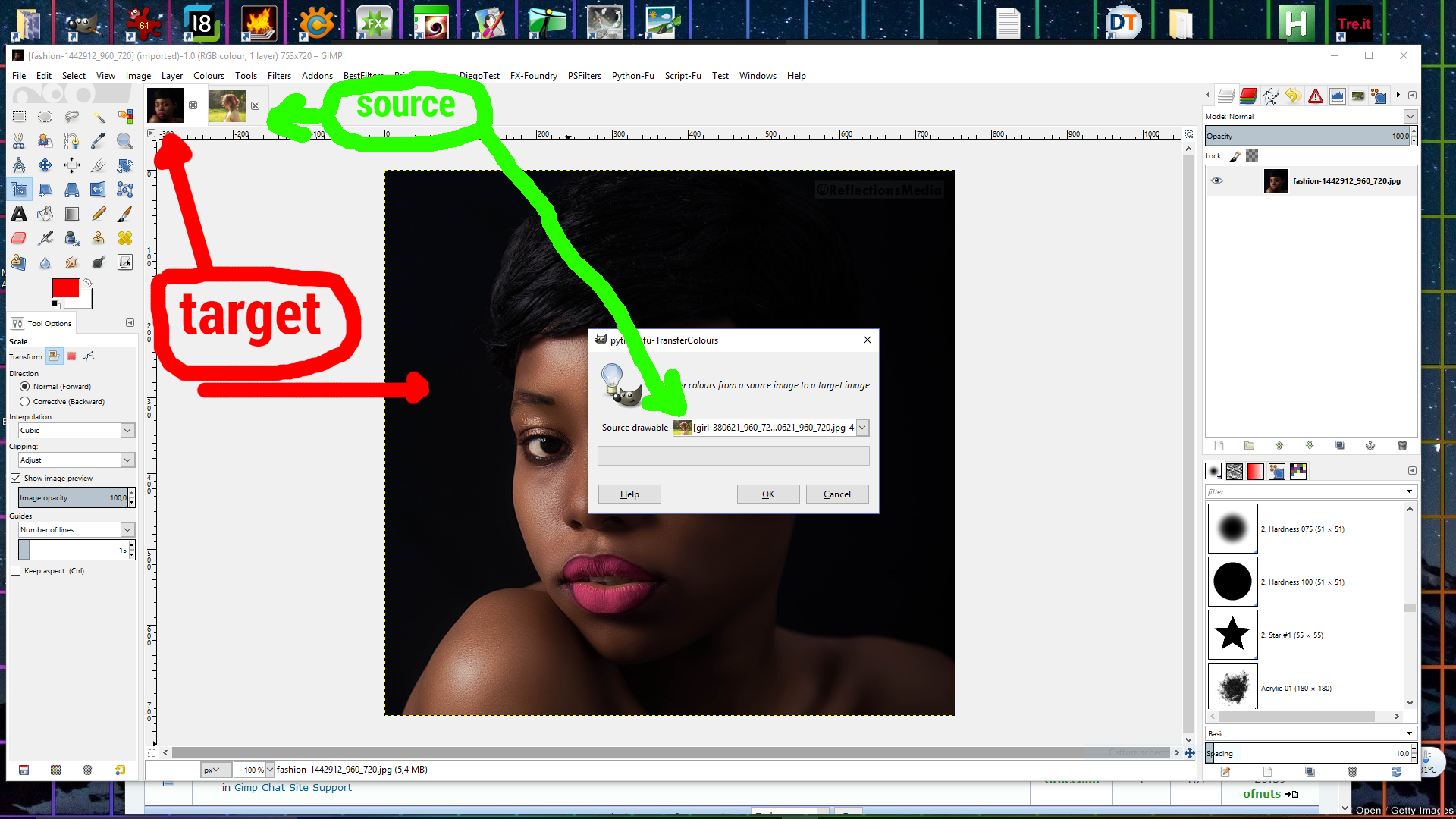

I can't figure out how to use it.
Where do you put the target image and the source image? Are they stacked in 2 layers or two separate images in gimp?
After I used the filter (tried to use it) I got the following error message.
Then when I tried to save one of the images as a jpg I got an error mentioning py and whatever. Had to shut down gimp, go delete filter then re-open gimp in order to save an image as a jpg. I saved the images I wanted to use as xcf files.
 Post subject: Re: new filter "Transfer Colours"
PostPosted: Sun Jan 29, 2017 1:54 pm  (#8)
O,
1.you need to have Stretch RGB Colours installed
see http://gimpscripts.com/2016/08/stretch-rgb-colors/
2.you start the filter from the target image and make reference to the source image, which must be already open
3.I do not understand

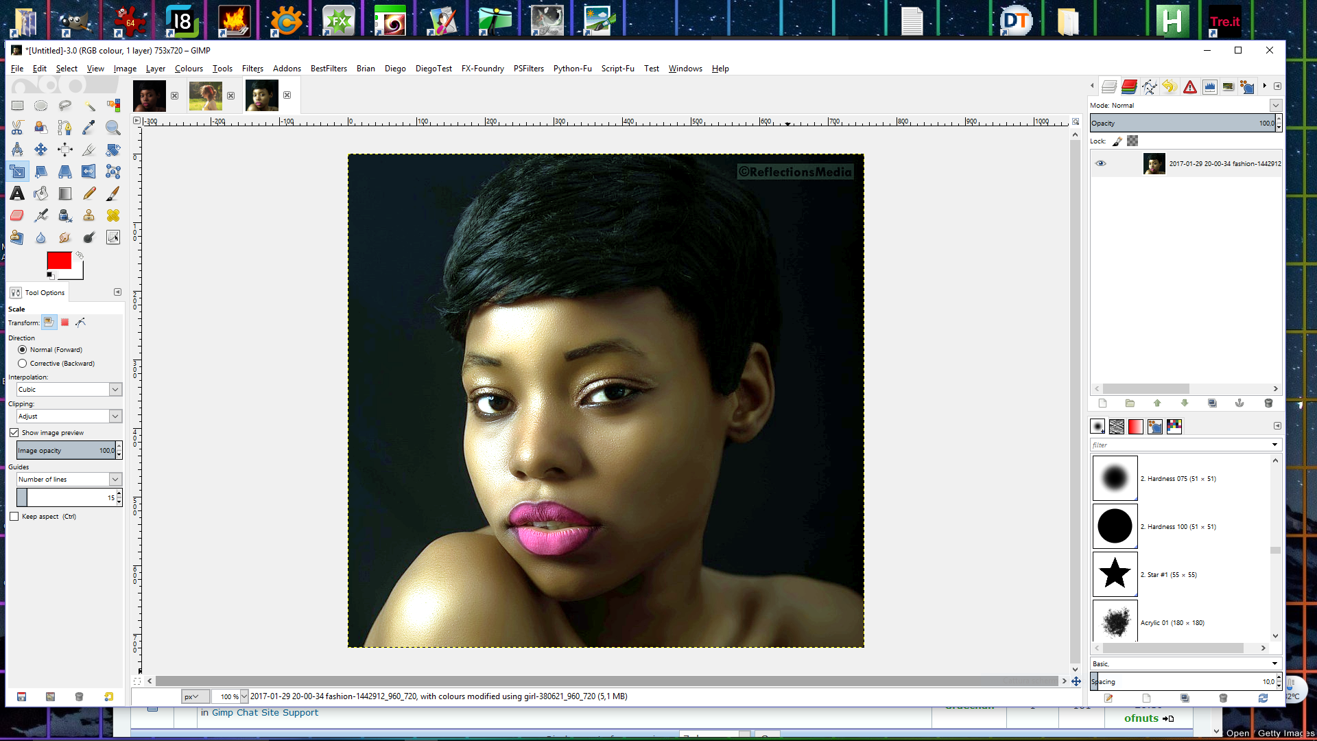

Maybe this can help:
starting the filter
result after run

Leave it to me to make something hard out of something simple. Very nice filter, Diego!
PostPosted: Sun Jan 29, 2017 10:57 pm  (#13)
Nice outcome, O.
Thanks!

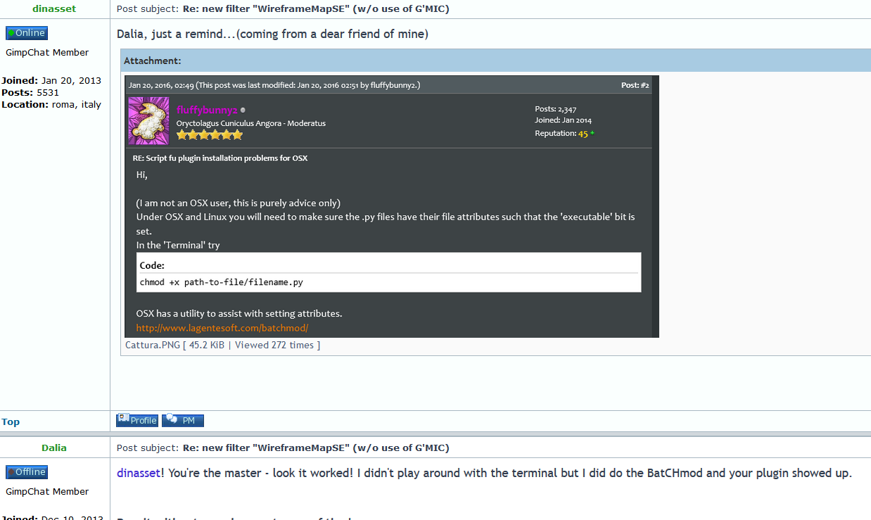

Recalling something similar occurred to Dalia
see attachment
PostPosted: Mon Jan 30, 2017 12:32 pm  (#20)
I don't really know how to use terminal! I am not sure what to type in exactly, and then what to do with the results.
