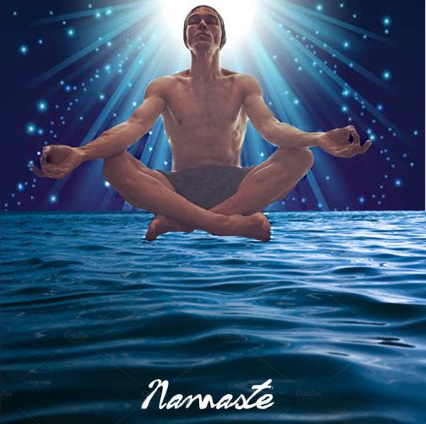

I have been looking via the search box for a script on how to make it look like water is moving but so far no luck. It seems to me that there is a script or filter that does this, but I am not finding anything. I am making a picture and wanted the water area to look like it's gently wavy.
Have you looked into the,
Filter>Distorts>Ripple effect?
You can also check out,
Filter>Animation>Rippling

PostPosted: Tue Mar 21, 2017 10:27 pm  (#3)
I didn't try filters>distorts>ripple because I didn't think it would have movement. I did try the animation one but not sure how to make it only work on the water part of the pic. I think I have to finish the picture first, then figure out how to make only the water animated on the finished jpg or png.
You can do the animation on the entire image.
Then place a copy of the image on top of all the layers and use a layer mask.
To mask out the water.
After the masking is done and applied to the top layer/image.
Move it all the way to the bottom and use,
Filter>Animation>Overlay Background.
Delete the this bottom most layer,
to finish the animation.
That's how I did this image below...

PostPosted: Tue Mar 21, 2017 11:23 pm  (#5)
Argh, can't get it to work right. on the layer mask, when the white is at the bottom, the top part doesn't show, all you see is the water rippling, when the white is at the top, the top shows but it's also rippling while the water is hidden. grrrr.

PostPosted: Tue Mar 21, 2017 11:26 pm  (#6)
This is the picture I'm working on...I just want to know how to get a gentle wave action on the water. I was also thinking about adding his reflection in the water but that seems to be too much to deal with, lol.
***edit...never mind, I finally got it! Thanks so much Wallace, I could have never figured it out without your instructions! But, heh heh, now I have to figure out saving as an animation.

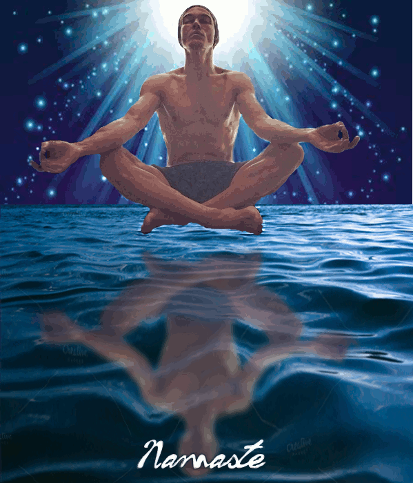

 Post subject: Re: rippling water
PostPosted: Tue Mar 21, 2017 11:44 pm  (#7)
Posts: 14169
You mean like this?
PostPosted: Tue Mar 21, 2017 11:47 pm  (#8)
I saved as .gif...it was the only thing I could think of. I love your water, is that animation waves? What settings? And the reflection! Do you have that in the full size and can I have it? Lol.

Posts: 14169
testing...
That's it!
The image I made had 129 layers,
with a disposal of 125 per frame.
The "Rippling Strength",
was left at the default.
The number of frames was 129.
It was to many MB to upload,
so I shrunk it down.
I didn't save it in the original size,
but I did have it in it's original size.
I can make you another one,
but it's too many megabits and can't be simply uploaded to Gimp Chat? :(

@2-ton,
I just couldn't resist having a try!!!
I used liquid rescale to make a bit more room for the reflection and thought that the title should not, perhaps, be wavy.
david.

Posts: 875
Filters>Animation>Waves will work within a selection. For my attempt I used Wavelength=60 and Amplitude=1
It is a pity that when saved as a .GIF that posterisation occurs - right up to that point the quality is excellent.
