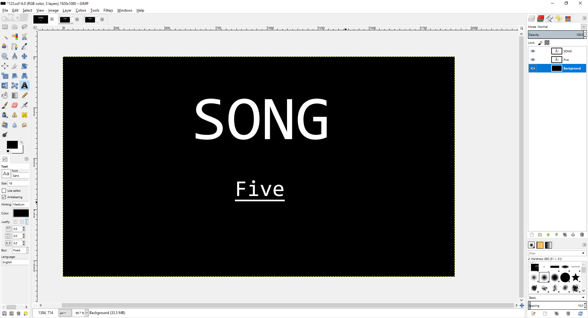

While the script can run successfully, it doesn't change the original .xcf picture at all. I'll try my best to explain what exactly I am trying to do with the use of pictures.
I had thought that I needed to use the "pdb.gimp_text_layer_set_text" line, but it seems that it needs to be defined using the "layer = pdb.gimp_text_layer_new" line. If there is any way to do what I am trying to do, please let me know.
Also, thanks for the reminder about the
formatting. I edited my previous posts to make it much easier to read!
If you want th XCF file to change you also have to save the image.
Still not clear... You create the layer with some text, and then before using the layer, you change the text. Why not create the layer with the final text directly? When you change the text of the layer in the script, the layer is not resized, so at best the text won't be centered in the layer, and in many cases it will be cut off. So even if the layer existed before, it is often a better idea to delete it and recreate a new one.

TRBear wrote:
Also, could you tell me what you mean by saving the image? I could not find any script on the Python Procedure Browser that would do that, so if you could provide me with what you have in mind, that would be appreciated.
pdb.gimp_file_save() or even better pdb.gimp_xcf_save().
