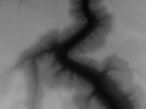

I deal a lot with heightmaps, which you can take to be grayscale images for which pixel values change "smoothly" in any direction.
It would be helpful sometimes if I could "see" adjacent contours of individual pixel values "next" to each other. I think what this means is that I'm looking for a way to map values which are adjacent in the original to values, gray or color, which are "far enough apart to be easily detectible" in a new pseudo-colored image.

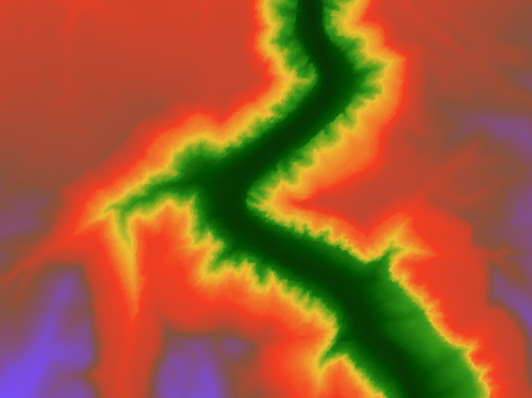

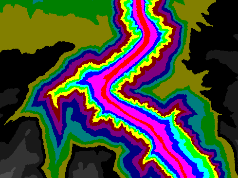

I selected the tropical colors map for an initial experiment with Colors->Map->GradientMap, which does give a hint for what a result might look like, but still results in grayscale values near each other mapping to shades near each other.

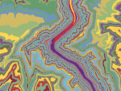

Actually, I got something more like what I am after with the Skyline gradient and Map->GradientMap.

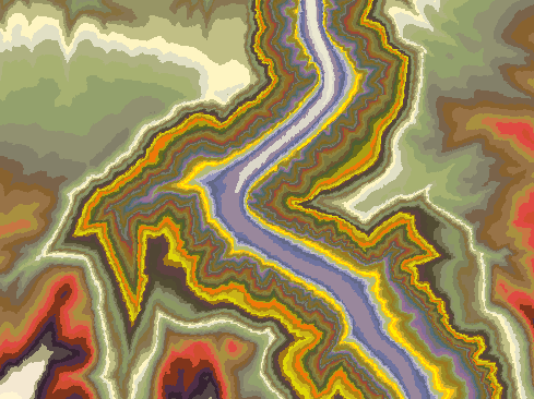

Starting with my initial b&w heightmap, and running Colors->Map->GradientMap with a new palette derived from tt's plug-in, I got this finer-grained result, making it easier to perceive where elevation changes occur than in the original's continous-ness.
Thank you for reading along.

This is a sample outcome, using your B&W image.
not so extremely detailed as in your outcome, but quite good.

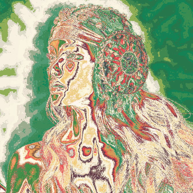

Surely THIS must be Artistic?

From an "artistic" viewpoint, what about this mapping? (657)

[quote="dinasset"]From an "artistic" viewpoint, what about this mapping? (657)
Very Nice. May I guess that the underlying image is color, and not like my earlier B&W examples?

Yes, I started from a (very nice) colour painting
