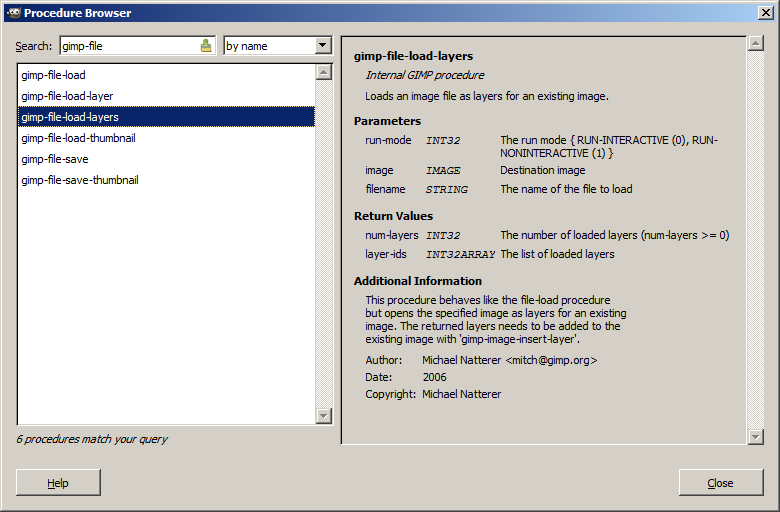

The procedure browser is your friend:

Thanks paynekj, this puts me on the right track. I do use the PB but sometimes am unsure which of the similar procedures to use
