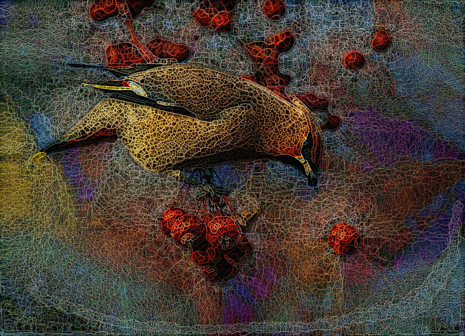

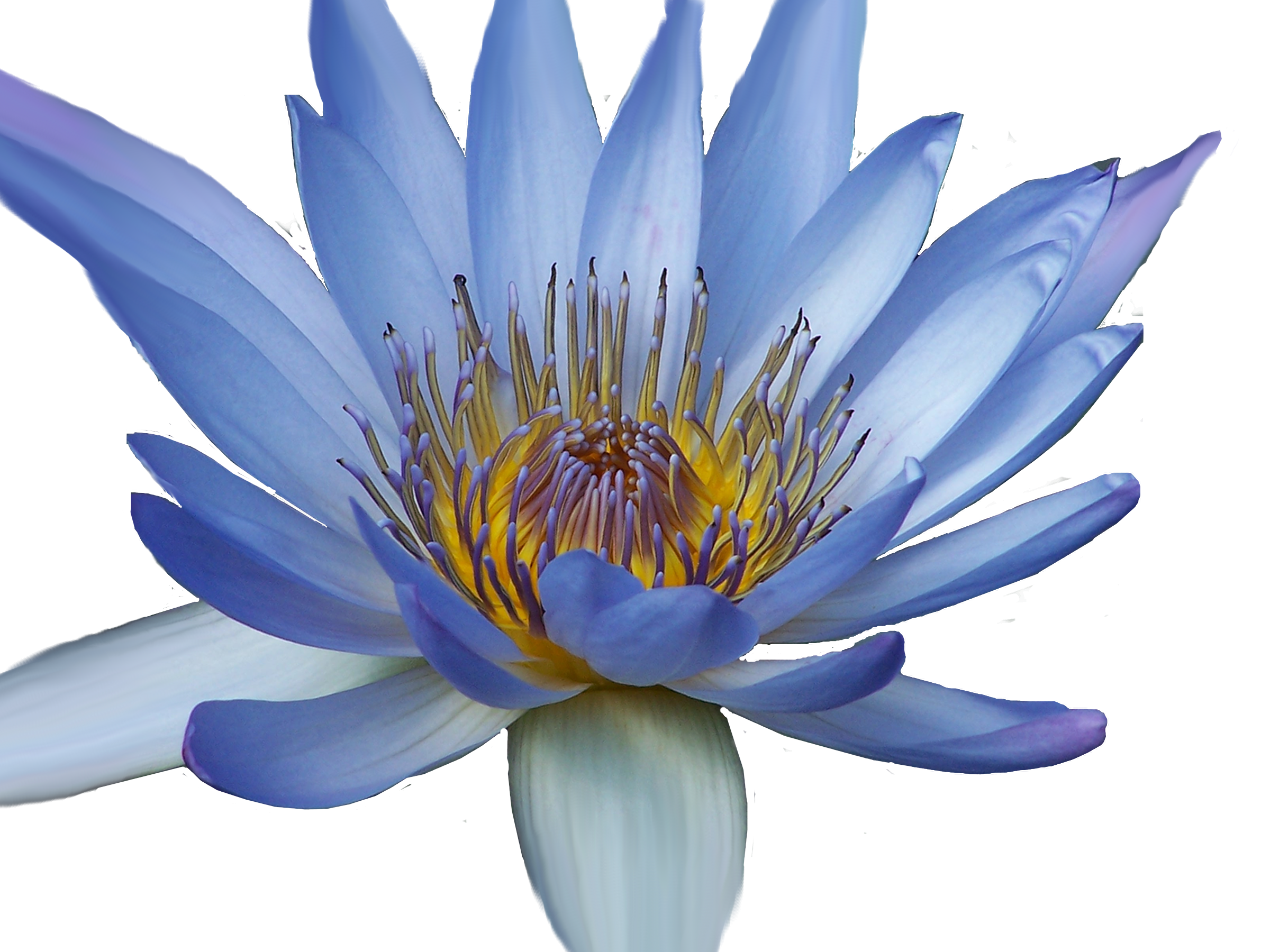

Here is the first example.
There is a 7zip file with the complete instruction at the bottom.
SpiderPaint Instruction One.7z [4.36 MiB]
Downloaded 243 times

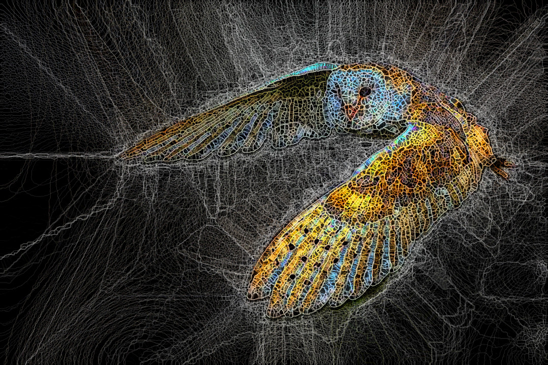

Here are the 2nd set of instructions
There is a zip file with the complete instruction for this one.
SpiderPaint instruction Two.7z [5.05 MiB]
Downloaded 303 times

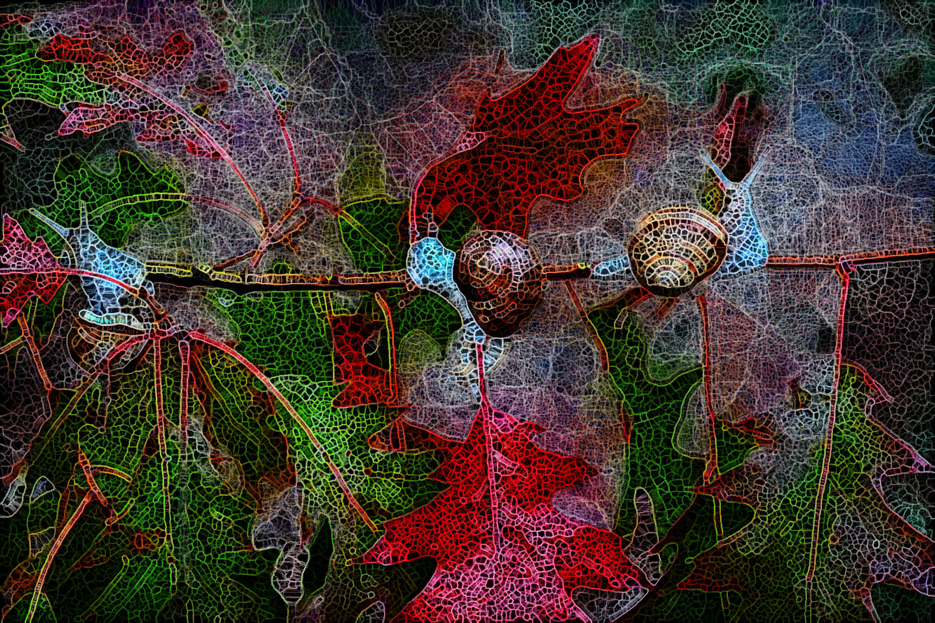

And the third
there is a 7zip file with the complete instuctions.
SpiderPaint Instruction Three.7z [2.88 MiB]
Downloaded 292 times

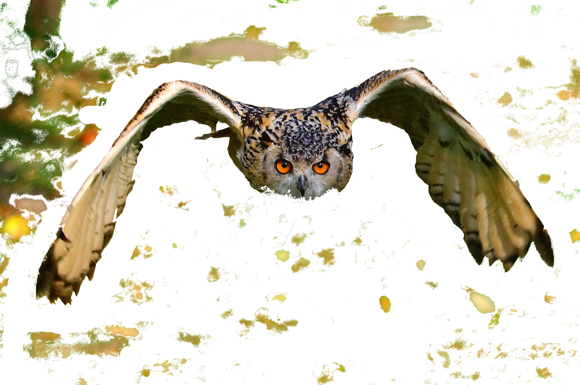

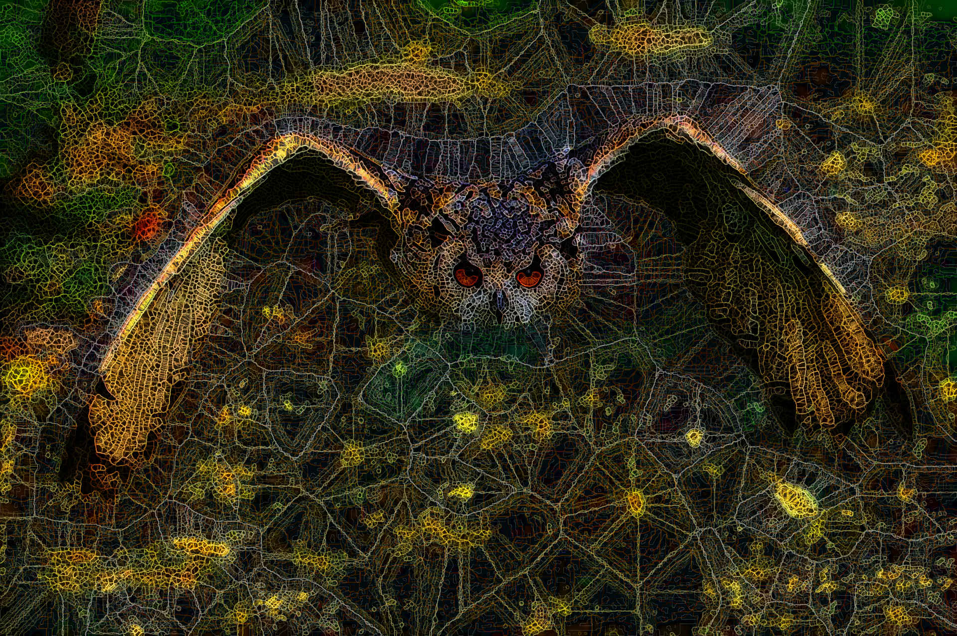

And the 4th and last for today.
The zip file is 2 posts down...

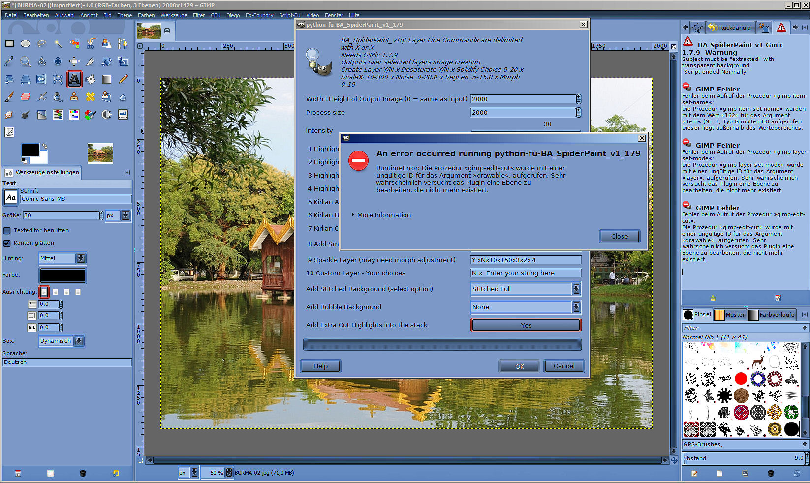

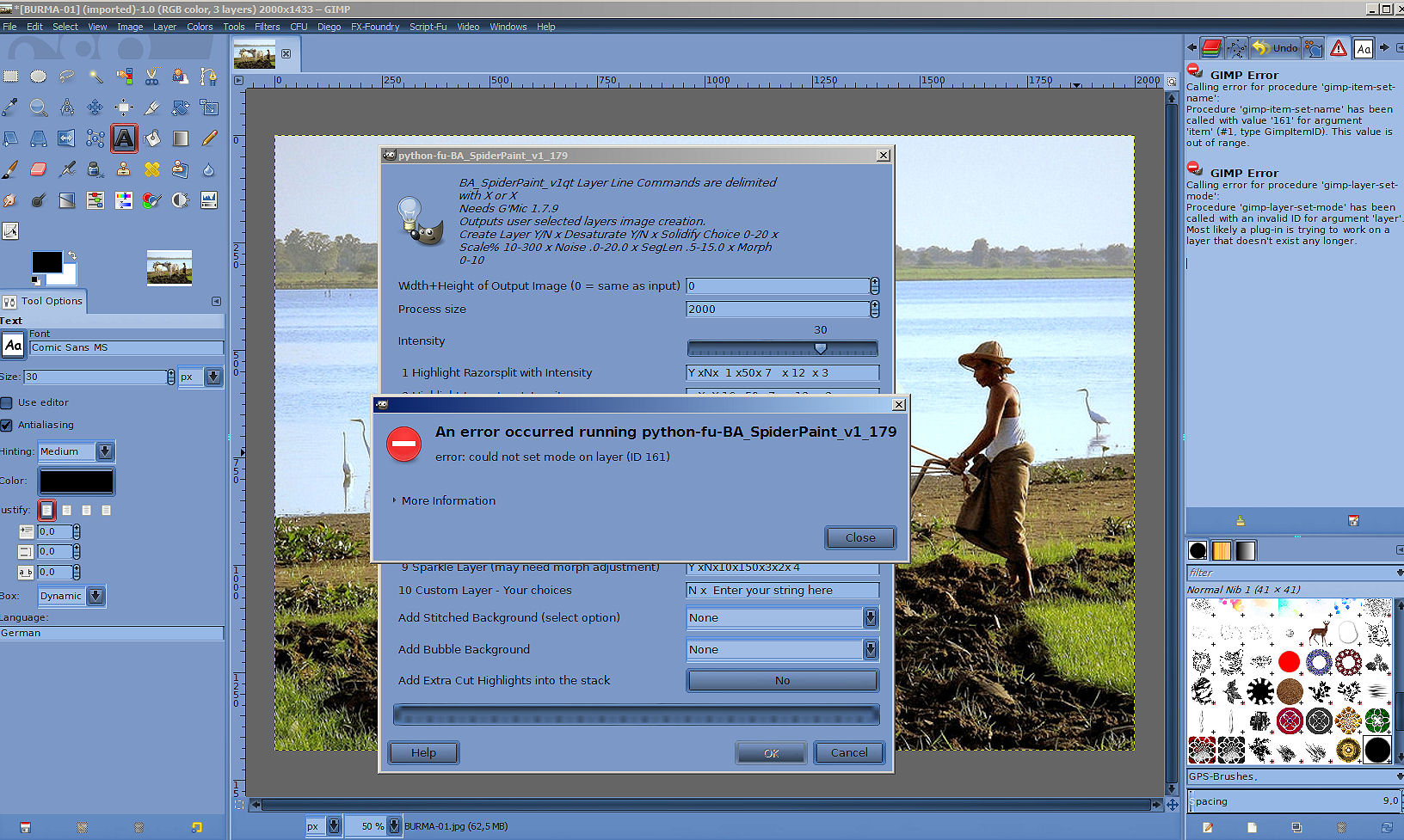

Hello,
The script does not run on my computer.
Error 1 = System language german
Error 2 = System language english.
My Installation WIN 7 Gimp 2.8.20 G'Mic 1.79
Greetings Hardy

I've tried this nice script but it does nothing on the picture. No errors appear either.
Issabella,
The only way I can get it to do nothing with no errors is to
have the Error Console Tab open and use a regular .jpg image.
It will give an error message popup if the Error Console tab is not open.
--- if the image is just transparent and black it will not work,
just change the color from black to gray or another color.
This script needs a subject image which has an alpha channel and
has some area erased so that there is a clear area showing so
that the background layers have a work space.
Are you using G'Mic 1.7.9 ?
Are you using an extracted subject with alpha channel?
Maybe try downloading a new copy in case it was corrupted.

Hardy,
Yes, the error message was due to using a subject image which had an alpha channel, but
it had no transparent areas for the background layers to be created on.
Nice Shoe!
