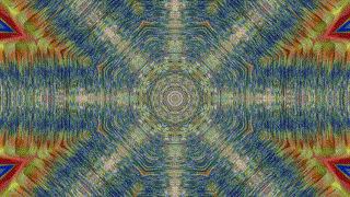

I'm just wondering if this script could be useful to me, as it came with GAP, and although it doesn't seem to work, I'm intrigued as to what it can do compared to the regular GEGL 'Mirrors' filter, A.K.A. Kaleidoscope (in GIMP 2.9) - obviously it's designed with animation in mind... so would be nice to give it a go if at all possible.

This works in 2.8, by FencePost and later edited by samj.
I have changed the menu entry to "animators"

Seems okay, I had to also download the package that included the Kaleidoscope.exe file etc from.. viewtopic.php?p=84084#p83992
Cheers! :)
