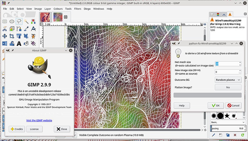

I've changed the values (0 to 1), but the parameters are still 7 in my system, look:
and: the filter runs correctly on my PC
Which error do you get on that instruction?

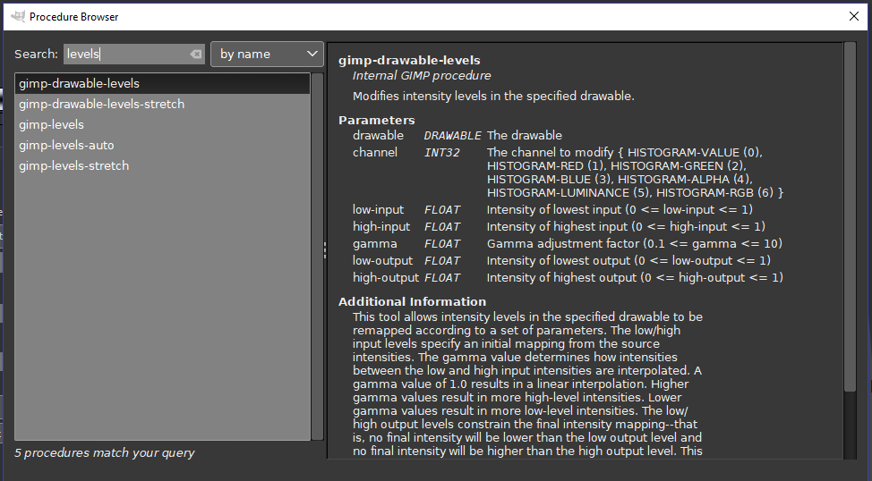

It is very strange that the number of parameters changes depending on: 32bit or 64 bit. :geek
In my Vista 32bit system (the newest version of Sam from 2018-01-05 "Version de développement Gimp 2.9.9 Portable 32 bits and 64 bits Windows" http://samjcreations.blogspot.it/2018/01/version-de-developpement -gimp-299_5.html) after unpacking (without any changes or additions) there are 9 parameters:
