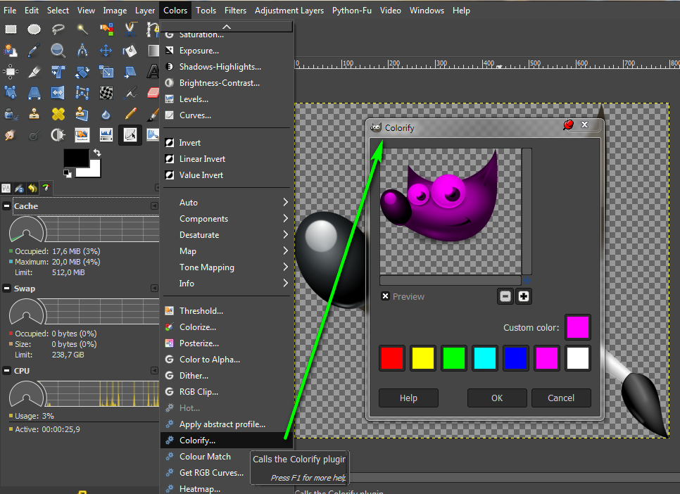

PostPosted: Sun Jun 10, 2018 3:45 pm  (#7)
Still another (old) solution - an interactive call...
#!/usr/bin/env python
#-*- coding: utf-8 -*-
from gimpfu import *
def plugin_main(image, layer):
    pdb.plug_in_colorify(image, layer, (1, 1, 1, 1), run_mode=RUN_INTERACTIVE)
register(
    "python_fu_colorify",
    "Calls the Colorify plugin",
    "Calls the Colorify plugin in Gimp 2.10",
    "Skinnyhouse/MrQ",
    "GPL",
    "2018",
    "<Image>/Colors/Colorify...",
    plugin_main)
main()
Colorify_Run_Interactive.zip [414 Bytes]
Downloaded 305 times
 Post subject: Re: Colorify in Gimp 2.10
PostPosted: Sun Jun 10, 2018 4:41 pm  (#8)
Posts: 2861
Of course - a much better solution than mine.
