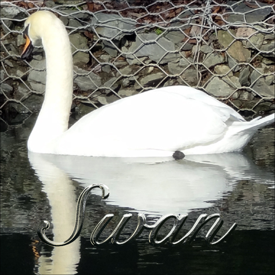

PostPosted: Sat Mar 10, 2018 6:48 pm  (#11)
Your script already works with a flat image if I start with a square dimension image. The only problem is that it enlarges it before applying the effect.
 Post subject: Re: Not bevel, just Reflect... Script (Experimental)
PostPosted: Sat Mar 10, 2018 7:35 pm  (#12)
Posts: 4528
It needs information outside of the inner square to do reflections.
That's why that helper script is there so that you get your same image back if you turned it to reflect emap.
Flat area reflects directly, but areas with slopes will reflect from outside the image if they're close to the outer boundary of images.
Above, the blue on top represents light shown to you.
short blue on bottom represents a flat area, where light just comes from inner square.
red on bottom represents a sloped area close to the border of image, see if i only used blue area on top as emap then I would have no information for red ray coming in... i need to make the emap larger to allow information from outside of the blue on top.
TinT

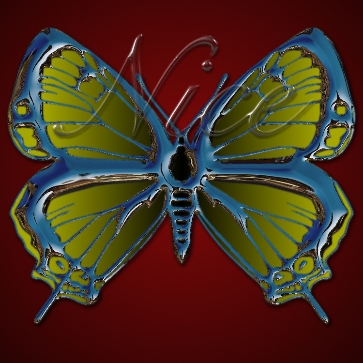

PostPosted: Sun Mar 11, 2018 6:49 pm  (#13)
I figured out an easier and faster way to make beveled clear text. Thanks just the same.
I used BRL, followed by "Color to Alpha", De-Saturated, then added a drop shadow.
