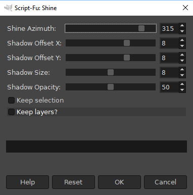

Since it was in my mind I thought that I would make a couple of additions to Graechan's nifty little script and add an option to the filter dialog to set the azimuth of the shine and options to set the shadow offsets. Negative values can be added to match the shadow to the shine's azimuth - not a very elegant solution but it works. Please remove earlier versions of the shine script from your 2.10 folder.

The new filter dialog:
