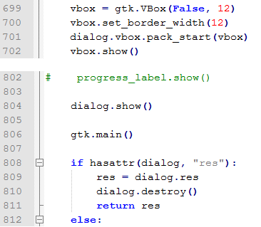

I think a mistake in annex (not the new file) ?

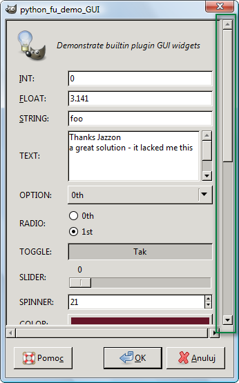

After making changes works well.
A great solution - it lacked me this.
Thanks Jazzon.
