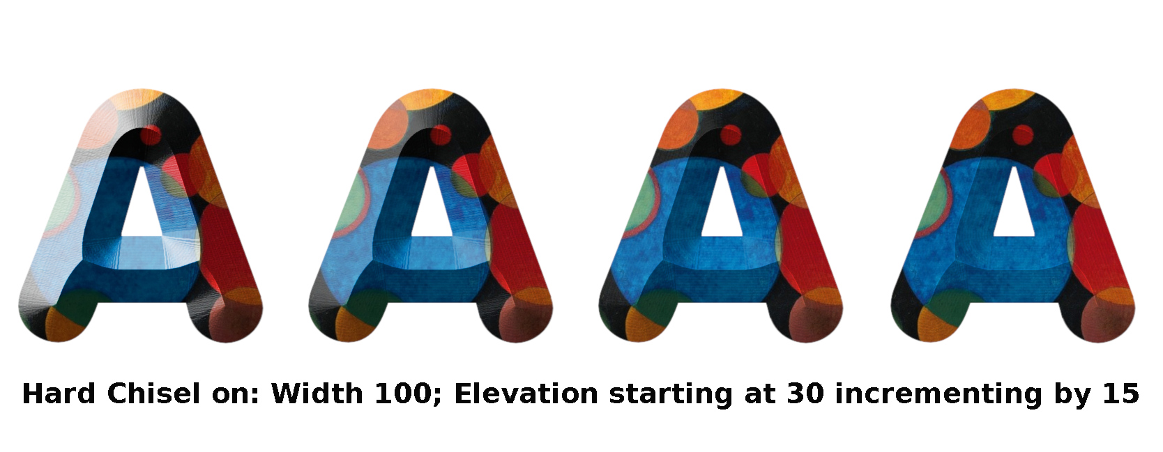

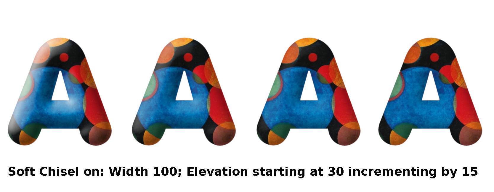

To redress the balance, here are a few examples to show the effects of changing the elevation setting when using the chisel option – and the difference between the hard and soft chisel effect.
