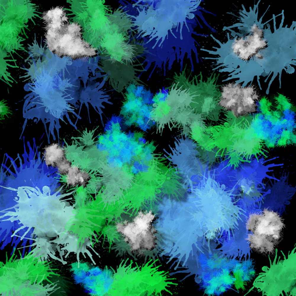

And last for now - some more abstract images that I have used recently.

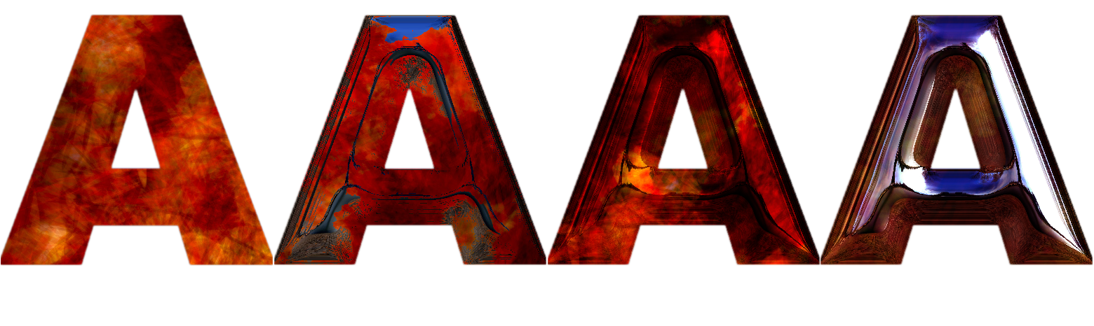

And a test with Racer X's Chrome Racer custom font using the earthy image from above.
Normal - Chroma - Hard light and Soft light modes:

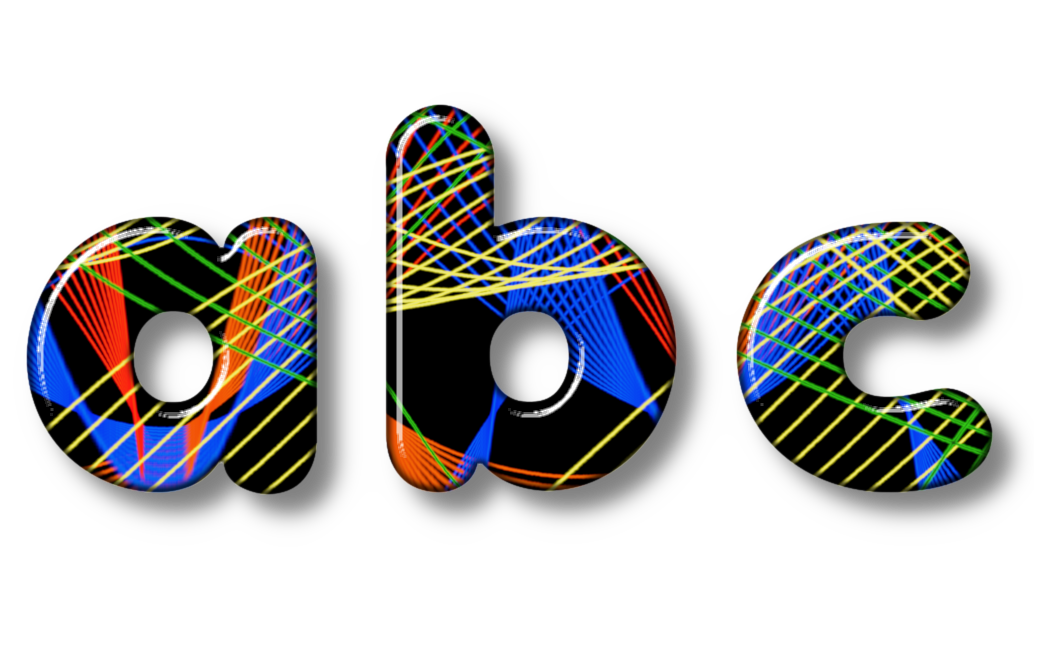

And examples of the style of font face created from the images...
