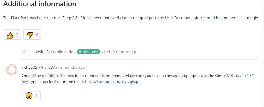

Follow Rich's instruction, you will find it again.

Look.

It came up, but there should be an easier way to get to it without having to search for it in the commands.
