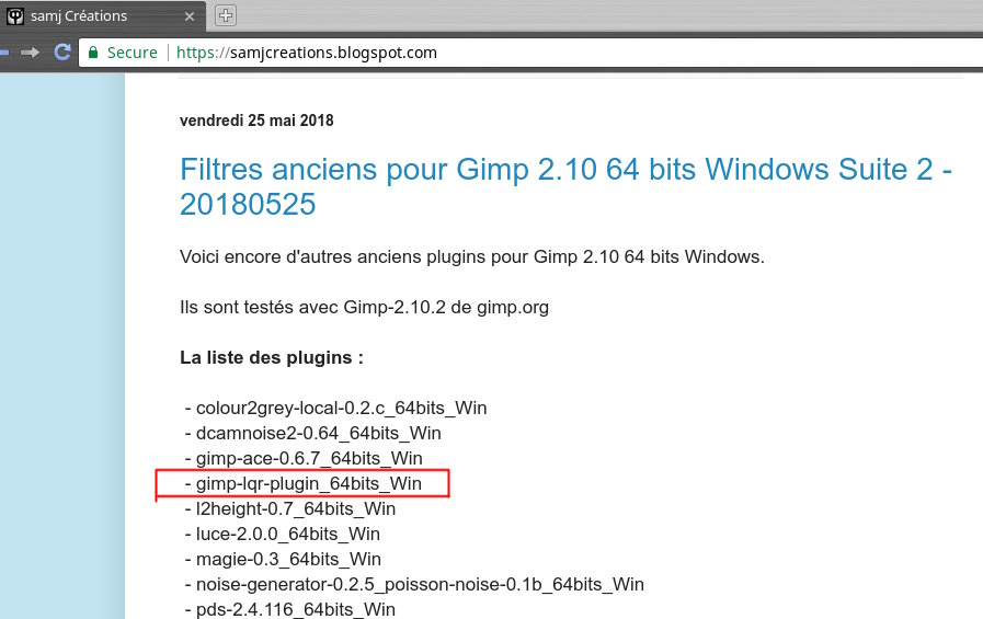

Go to https://samjcreations.blogspot.com/ and scroll down until you hit Windows Suite 2
and download it.

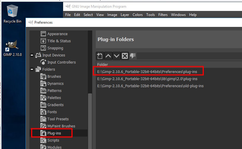

Next (and it is the same for any Gimp, any platform) look in Edit -> Preferences -> Folders -> Plug-ins for the correct location of the Gimp user profile. The portable uses Preferences

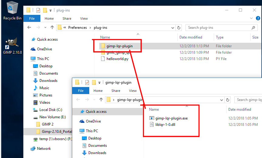

Take the 2 files gimp-lqr-plugin.exe & liblqr-1-0.dll and put them in a folder gimp-lqr-plugin (same name as the plugin without the .exe) Put that folder in the Gimp portable user plug-ins directory.
Note: It is not necessary to add paths in Gimp 2.10 Providing the folder is the same name as the plug-in putting the folder in 'plug-ins' is all that is required.
