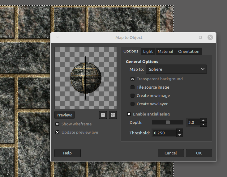

No plugin needed. Filters > Map > Map Object.
