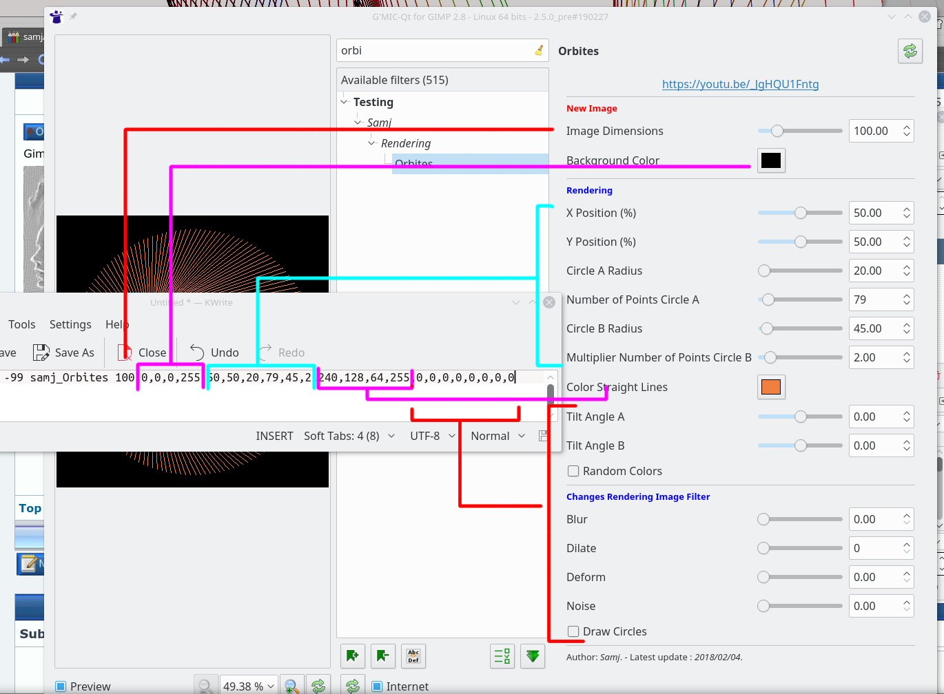

Sometimes worth enabling the gmic_gimp log. gmic -> settings -> other
The extra settings are the colours: R, G, B + Alpha and there are two of those. Then there are the tick boxes to take into account, not ticked but still have a value.

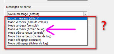

thank you rich2005 Image for your detailed explanations.
In "other", what should I change?
Image Image
 Post subject: Re: samj/Orbites
PostPosted: Tue Mar 19, 2019 8:28 am  (#4)
Posts: 2613

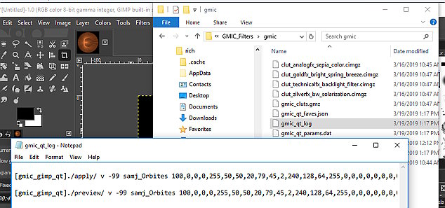

1) Use the 'verbose' to logfile
Find the log file gmic_qt_log in the samj folder GMIC_Filters\gmic

I opened the file "gmic_qt_log" in notepad ++ while I opened G'Mic, and then I saved the file.
Sorry to be so silly, but when I open G'Mic again and the filter Orbites, I searched in vain how I could test each of the command lines .... If I open again the file "gmic_qt_log ", I see the lines and others corresponding to filters tested later.

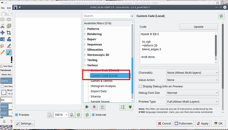

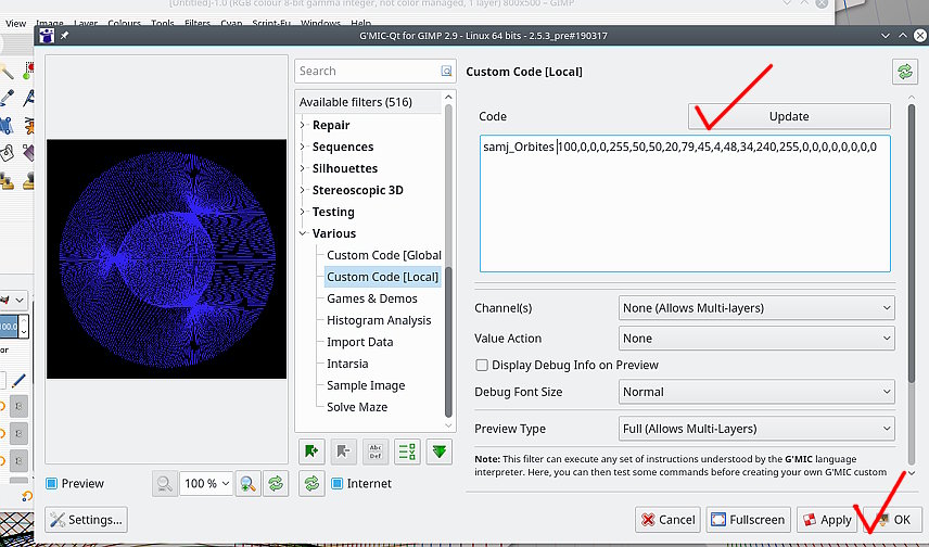

If you go back to your first post one of the samj commands is
samj_Orbites 100,0,0,0,255,50,50,20,79,45,4,48,34,240,255,0,0,0,0,0,0,0,0
Bottom of the gmic_gimp menu is Various -> Custom Code [Local] you can use this to test the code.
Initially looks like this:
Just delete that text and (copy/paste) put the new text in.
Update will give a preview and OK will render the filter.
What else can you do with the log file entries.
The script attached, easy to paste the gmic command in. Just be careful about line indents and quotes. Open it up in notepad++ easy to see the added lines. Just a couple of lines I added for this post. Renders that samj code then adds another filter.
It is a script, put in your scripts folder. Find it bottom of the Filters menu along side gmic.
