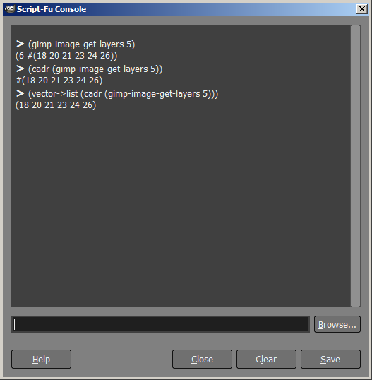

Provided you can identify the image id, you can use the Script-fu console to enter the commands manually:
So, yes, the "list" of layer-ids is an array (or a vector in Script-Fu)
Here I've converted the vector into a list using vector->list

Any chance you could explain what cadr does in that command? I understand the rest of the command but am unfamiliar with that command.
thanks :)

So correct me if i'm wrong but this line
(cadr(gimp-image-get-layers 5))
is basically say get the first item (car) and get everything but the first item (cdr) thus the abbreviation for cadr?
and then vector->list(cadr)
is basically the same thing? include first item in the vector and include everything else other then the first item in the vector thus cadr and then make it a list?
can I call that same line with a variable in front of it to then store the list? so something like this
(layerList(vector->list(cadr(gimp-image-get-layers 5))))

Yes, cdr gets everything in a list after the first element and car gets the first element. cadr therefore gets the second element in the list.
Yes you can assign a variable to the result of (vector->list(cadr(gimp-image-get-layers 5)))
