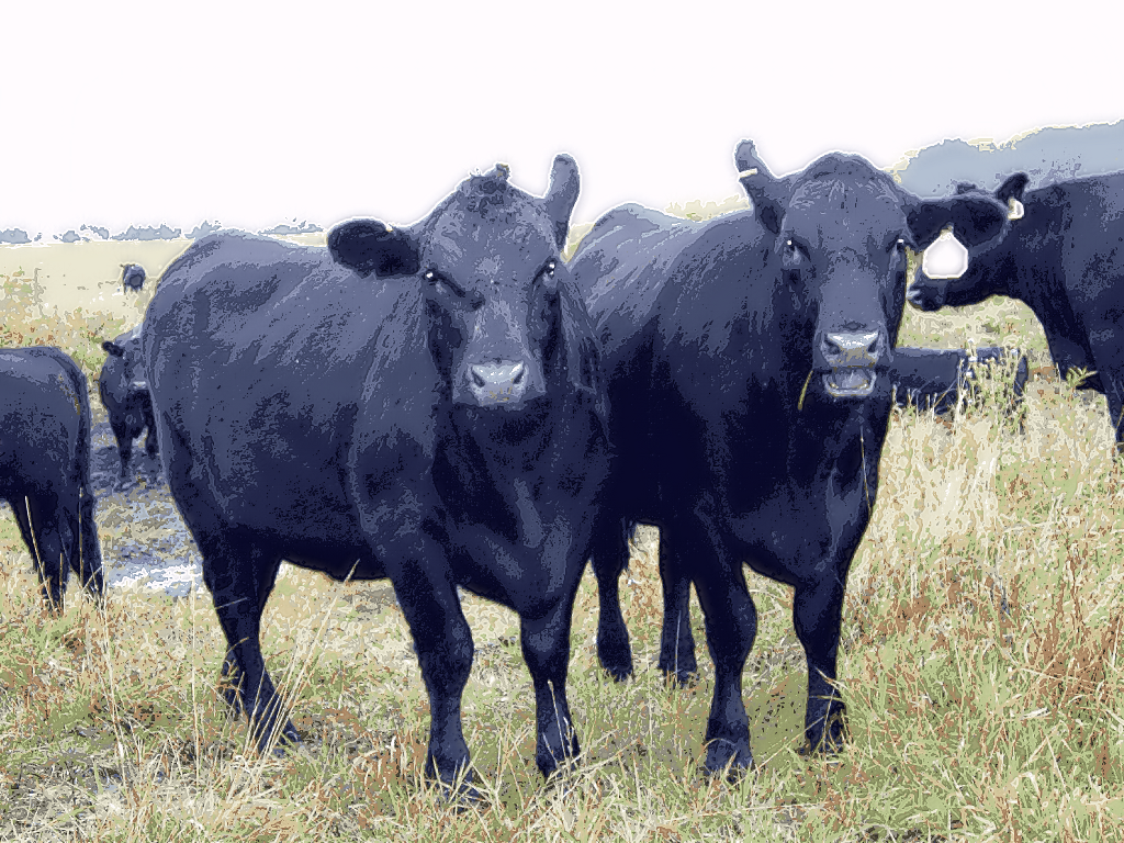

PostPosted: Thu May 19, 2011 9:19 pm  (#10)
I used the frog from the GIMP game post. I played with the settings and this one is the one I like best. Nice filter!

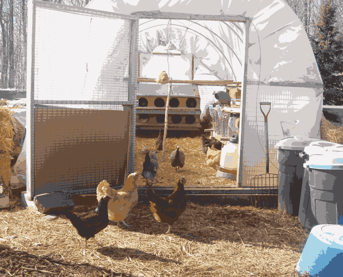

 Post subject: Re: An improved "posterize" filter
PostPosted: Thu May 19, 2011 9:24 pm  (#11)
Joined: Feb 06, 2011
Posts: 342
I like the filter too Saul. Thanks!!!
Liana

RobA wrote:
sg-
You must have missed my post last year:
viewtopic.php?f=9&t=556&p=5449#p5449
Indeed I had. Your palette selection and dithering options are interesting -- and I can see where they might be useful in cartography -- nonetheless I think I'll leave my script in its current state. I just feel it is more suitable to my needs.
@lianam, those are very nice. I particularly like the chicken picture.
