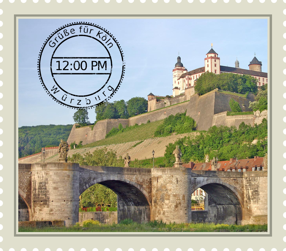

It crashes when I try to enter something with German Umlauts like cityname Würzburg or Köln or so.
Is there a way to enter those, too?
Regards
nelo
 Post subject: Re: Distressed Rubber Stamp Plugin
PostPosted: Mon Mar 18, 2019 6:45 am  (#13)
This is an old problem with a simple solution.
The text field requires UTF encoding - so for a non-English version you need to add:
   pdb.gimp_context_push()
   #core code goes here/below
   top_text = top_text.decode("utf-8")
   middle_text = middle_text.decode("utf-8")
   bottom_text = bottom_text.decode("utf-8")
   width, height = 1000, 1000

So easy.
Thanks a lot.
Regards
nelo
PostPosted: Mon Mar 18, 2019 9:48 am  (#15)
Posts: 4528
Thanks MareroQ,
Added this change to v5.
TinT
