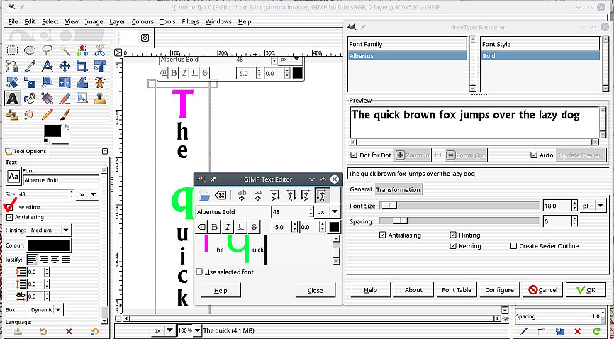

Straight forward compile here kubuntu 16.04 A .configure then a make Makes a single plugin, unsuprisingly named freetype. If you did a install then it will be in your user plugins folder or a "root" install in /usr/lib/gimp/2.0/plug-ins/
Interesting to use old applications (I still have Gimp 2.2 stuff in an archive) and Gimp plugins, but freetype was superceded by the much better Gimp text tool.
The on-canvas text tool is better again, more options to format. The option to use the Text editor is still there. Now includes the orientation toggles that you get with a right click in the on-canvas tool.
