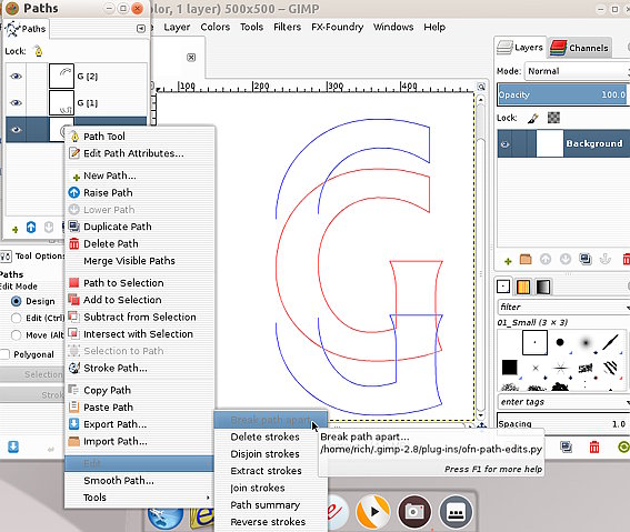

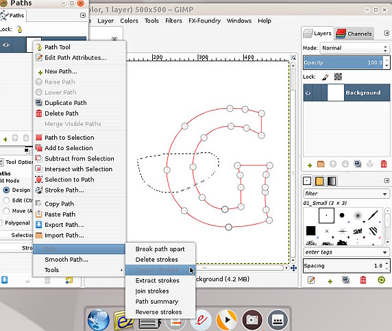

Here is an example:
Break a path at the nodes in a selected area (Disjoin)
Then create separate paths from the previous un-joined path. Break path apart.
