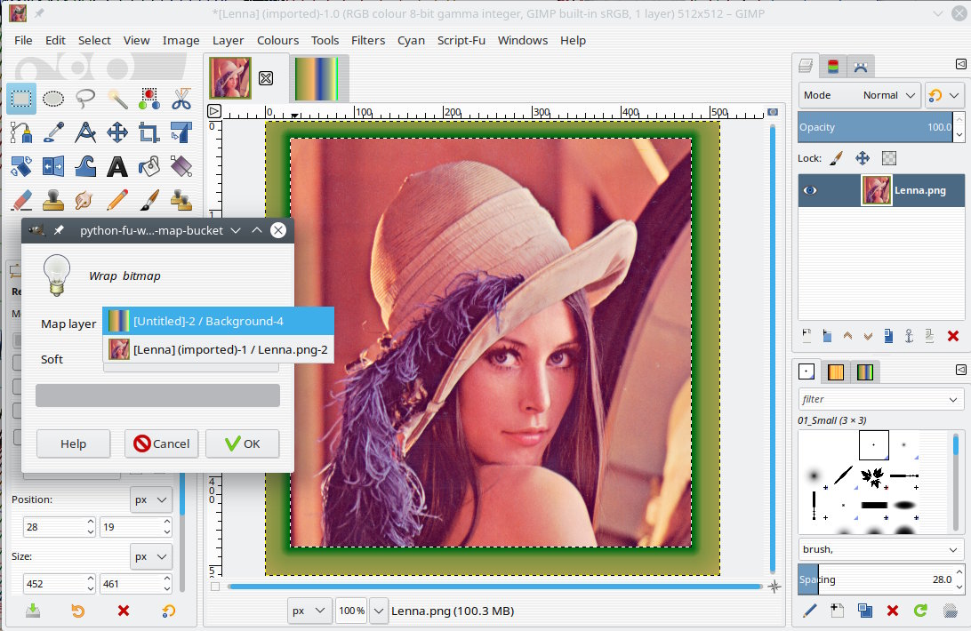

Still working here. kubuntu 18.04 Gimp 2.10.10
It is for making frames around a selection.
