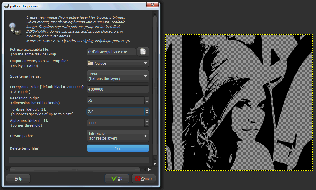

PostPosted: Sun Jun 09, 2019 11:27 am  (#1)
Plugin-potrace.py based on code plugin-trace ( http://gimpchat.com/viewtopic.php?f=9&t=17485) and Potrace by Peter Selinger.
In menu Gimp: Filters->Edge-Detect->Potrace...
Requires separate potrace program be installed.
IMPORTANT: do not use spaces and special characters in directory and layer names.
POTRACE - transform bitmaps into vector graphics
http://potrace.sourceforge.net/
DESCRIPTION
Potrace is a tool for tracing a bitmap, which means, transforming a
bitmap into a smooth, scalable image. The input is a bitmap (PBM,
PGM, PPM, or BMP), and the output is one of several vector file
formats. A typical use is to create SVG or PDF files from scanned
data, such as company or university logos, handwritten notes, etc.
The resulting image is not "jaggy" like a bitmap, but smooth. It can
then be rendered at any resolution.
Potrace can currently produce the following output formats: SVG, PDF,
EPS, PostScript, DXF, GeoJSON, PGM (for easy antialiasing of
pixel-based images), Gimppath, and XFig. Additional backends might be
added in the future.
A separate program, mkbitmap, is also provided. This program can act
as a pre-processor for Potrace, applying scaling and various filters
to an image before converting it to a bitmap. This is useful for
potracing greyscale and color images.
I do not know if it will work for Linux - so I invite You to Test...
plugin-potrace v 0.1.zip [2.78 KiB]
Downloaded 324 times

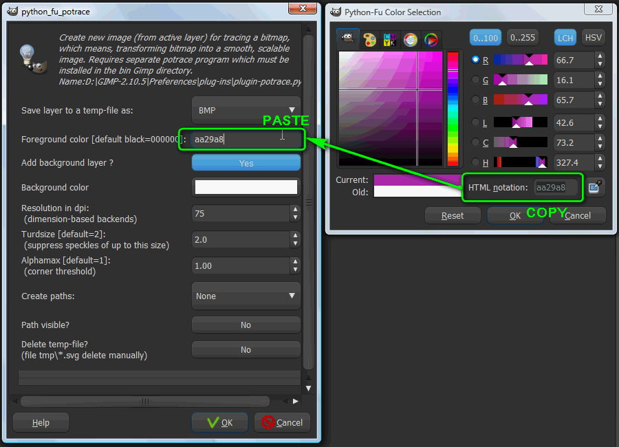

 Post subject: Re: Plugin Potrace
PostPosted: Sat Jun 22, 2019 12:41 pm  (#9)
Joined: Jun 22, 2019
Posts: 18
Hello All!
Gimp 2.10.12 - Linux Mint 19.1 Tessa
@MareroQ
Many thanks, MareroQ, for your really useful plugin!
Unfortunately, due to a different spelling for the parameter --color, the execution did not work on Linux.
The transfer of the color code must be in quotes! For some reason this is not documented and I had to try it for a while in the bash to find out.
To change the file plugin-potrace.py as shown below did the trick!
ImageImage[/img]
As I said, the plugin is very useful and it produces very good results!
That's why I think it would be great if the resulting SVG could be stored in a directory other than the tmp directory for further use.
Maybe that is possible?
Anyway, thanks a lot MareroQ!

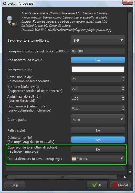

PostPosted: Sun Jun 23, 2019 4:11 am  (#10)
Hi C-T-S
Welcome to the GimpChat forum.
I'm glad you found a code solution for Linux. Since your patch does not work for Windows, I've added a selection of options for the system.
I never thought that this piece of code would be a problem (although I thought about changing the color code from RGBA to HTML, which Potrace needs - unfortunately without success, although there probably is some working code for RGB change (r, g, b, a) on #HEX).
Regarding svg file saving in another directory:
- it was in ver.1 but with the problem of spaces and national characters,
- in Windows, you can not even delete the temporary svg file (until the plugin has finished running), but you can copy a copy in any directory (no problem with characters and spaces) - but I do not know if you thought of this solution as useful?
ps. Really useful plugin?
The plugin-potrace is just a small adaptation plugin-trace of the best Gimp plug-in by Lloyd Konneker (bootch).
Great - three people have already been interested ...
