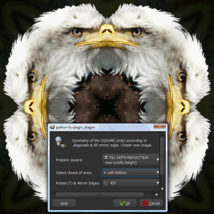

This plugin is a combination of codes and idea based by code:
- Tin Tran "Fill_rotate.py" https://gimplearn.net/viewtopic.php?f=3&t=1393
- Ofnuts "ofn-symmetries.py" (2016-09-29) https://sourceforge.net/projects/gimp-tools/files/scripts/ofn-symmetries.zip/download
Thank you to the coding masters. :hi5
In menu GIMP: Filters->Distorts->Symmetry->Symmetry by diagonal...
It's a bit easier to play with the effects of various symmetries - and it will be a continuation ...
Symmetry diagonal.zip [2.86 KiB]
Downloaded 228 times

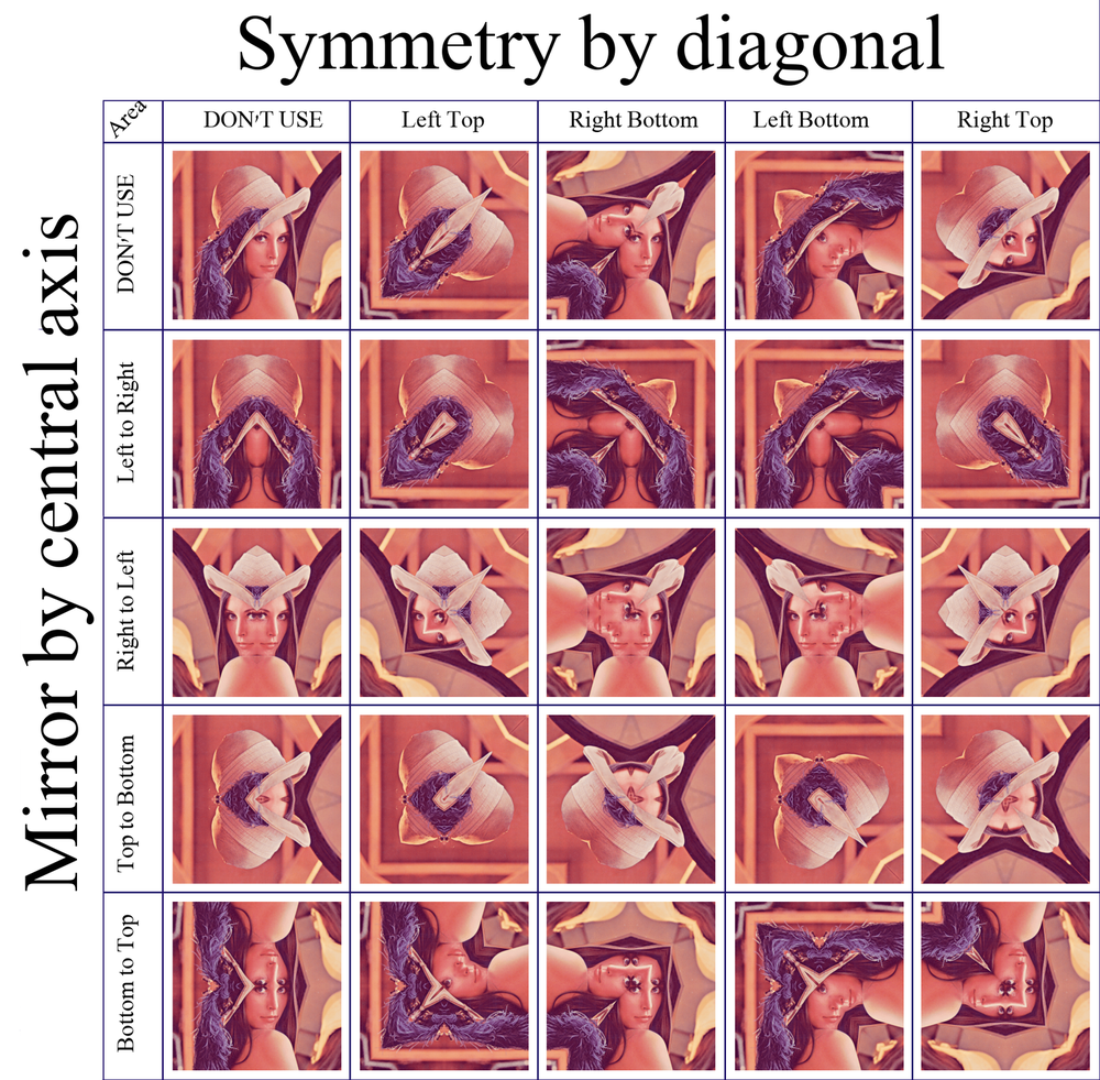

Rel.2
Add options: Size of the new image, Mirror by central axis(choose an area),Remove prepared square.
This plugin can be used for various purposes (eg easy creation of seamless patterns) but it was created as a complement (to prepare the source and to process the final) plugin symmetry_tile.py (with a great option to create your own compositions using a string)
Symmetry diagonal V-2.zip [3.54 KiB]
Downloaded 195 times

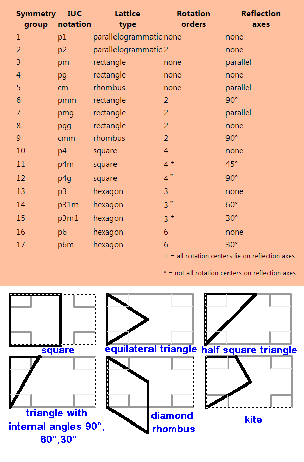

Symmetry tile.py
Author: Eleanor Howick
Download: https://github.com/elfnor/symmetrytile
The 17 plane symmetry groups:
https://www2.clarku.edu/faculty/djoyce/wallpaper/seventeen.html
The original plugin works without any problems for Gimp 2.10 but for my own needs I modified it a bit
(I added the number of tiles and disassembled the multiply mode for individual presets).
Modified plugin in menu Gimp: Filters->Distorts->Symmetry->Symmetry Tile...
Derived_cells and characteristics 17 different groups.png [ 35.11 KiB | Viewed 4229 times ]
Symmetry_Tile_mod.zip [7.81 KiB]
Downloaded 217 times

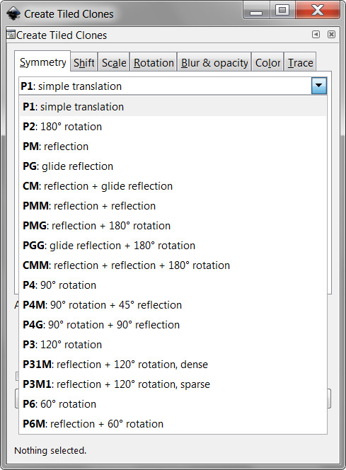

MareroQ wrote:
These symmetry groups are identical to the symmetry tab in Inkscape's tiled clones dialogue.
Always thought its something the Inkscape developers made up, but the links says:
The IUC notation is the notation for the symmetry group adopted by the International Union of Crystallography in 1952.
