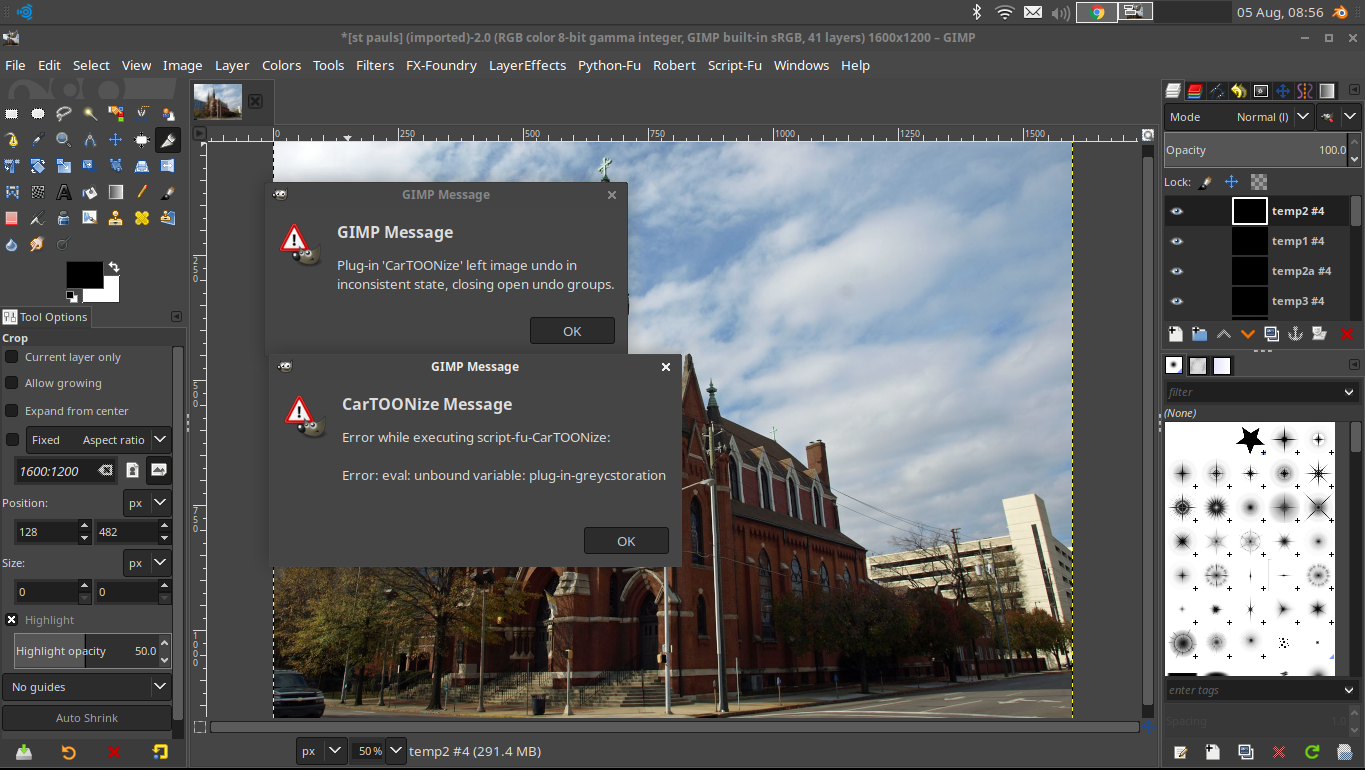

I am editing some non-working scripts and have come to an edit for which I have not found any information. As I try to run several scripts I am getting an unbound variable error, the biggest being the WHITE-IMAGE-FILL, which I believe I have resolved. But this following error, I'm not sure how to proceed.
Can someone advise on editing this?
EDIT: Well, this may be bigger than I thought. I correct on and another error pops up. Now on another script after the white-image-fill edit I am getting another, trans-image-fill. Are these scripts no longer usable in GIMP or do they require extensive editing?

you' re probably missing the greycstoration plug-in.
Not sure if it's still around. I think it was replaced by GMIC and its functions.

CarTOONize.scm (210_effects_CarTOONize.scm in the above) runs ok without greycstoration plugin. it is an optional pre-filter.
You can use greycstoration plugin in linux. As a stand-alone plugin it works fine. One of my favourites from older times. Unfortunately it registers in a strange way, with no parameters, so it applies only defaults when called from a script. There is a small difference with it on / off. but in my opinion not enough for the bother.

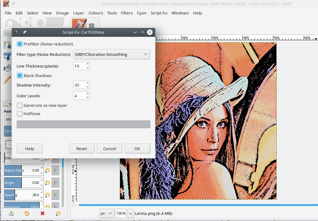

Want to try it. Should work with your 'buntu. Unzip the attached, CarTOONize-linux.scm goes in ~/.config/GIMP/2.10/scripts greycstoration64 goes in ~/.config/GIMP/2.10/plug-ins.
Note: the script still fails if you enable 'Halftone' - IMHO time to dump these old scripts.

Old 32bit plugins (unsharp-mask.exe for "Halftone" and greycstoration.exe) work well for me and are attached.
All changes (updating of procedures) are about one hour of work - I don't know if it was worth it...
210_effects_CarTOONize.zip [211.54 KiB]
Downloaded 338 times
