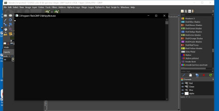

Hello Deigo
Can you please help with a problem running this scm.
I am using Windows 10. 64 bit Gimp 2.10.12
When starting up the script I get a black screen which does not go away until the process has finished. The end result is O.K.
In Preferences there is no longer a gimp impressionist folder. So where can I place the G1 presets.
Thank you
Hello Deigo
Thank you
Create both:
- under Preferences create folder gimpressionist
- under Preferences/gimpressionist copy the Presets folder I attached previously
edit: about the black screen I do not know, I use Samj's portable

MareroQ you are quite right glass frame is a plugin not a scm.
Too much self isolation not thinking straight.
Can you help with the black screen please.

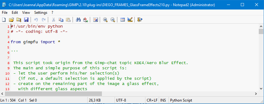

For Windows and Gimp from gimp.org and the Partha version, the initial 2 line is required:
#!/usr/bin/env python
# -*- coding: utf-8 -*-
Included in the attachment (for lazy users... :lol ).
Edition:
Author's version in post # 18
Instead of a code, a screenshot the shebang.
@Diego
In all plugins "Repository for Special Editions of Dinasset's filters"
viewtopic.php?f=9&t=14962&start=0
they are missing of this code - maybe just add information ?

@Dinasset
I have tried inputting the code and I still get this error:
Here is the code:
If I am inputting the code wrong, where does it go? I used NotePad since NotePad++ won't allow me to save the code. I am not a coder.
 Post subject: Re: glass-frame-effect.scm
PostPosted: Sat Mar 28, 2020 1:43 pm  (#18)
Try my current version and cross the fingers...
