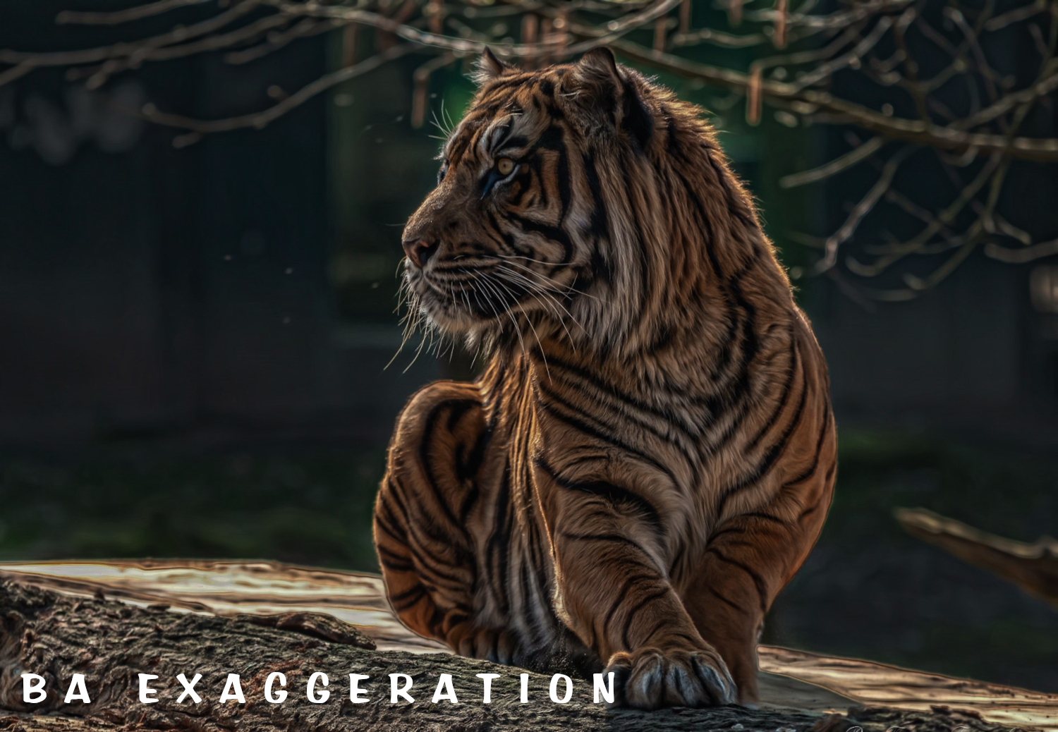

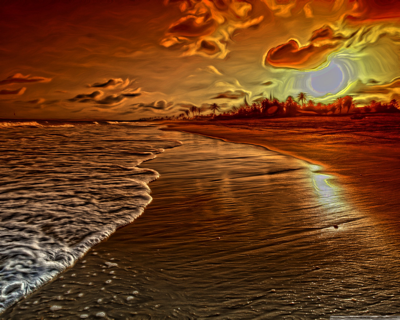

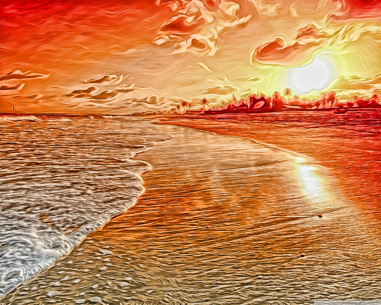

hardy111, I have these working in Gimp 2.10.6
But Flamboyance doesn't give the result which was expected, at least the one I remember it was. But works and it's different from Novella.
I post the ones I have.

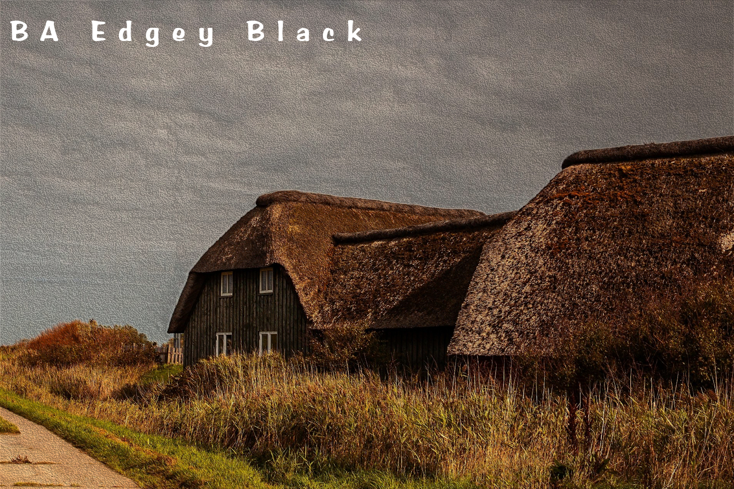

Zipped convolution presets and Edgey Black plug-in.
Works for me, but I tested so far only once, using same settings than I saw in the screenshot on the German Gimp site.
Never had these in 2.8, I like the result need to play more. Same menu entry.
Edit: One of the convolution presets, color invert gives an error. Error: set!: unbound variable: b
EdgeyBlack.zip [17.59 KiB]
Downloaded 194 times

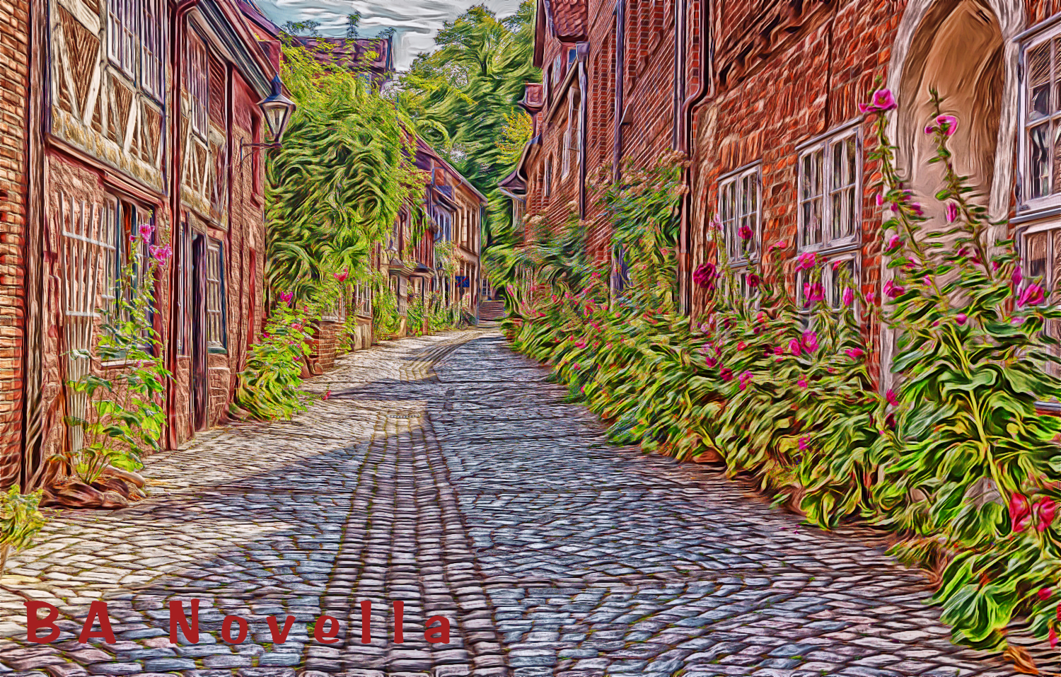

Hello and many
Thanks for your effort. Now the
filters work by Brian Anderson again!
Here are some results.
Best regards, Hardy

You're welcome Pat625. They are "quick fixed" and not behaving exactly like the originals on 2.8
The end result (top layer) is very close, but the extra layers below the top layer aren't in correct blending mode.
@hardy111, the last Novella pic is beautiful.
