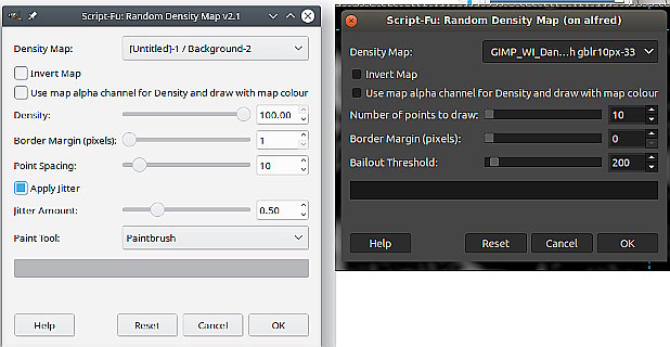

I forgot to mention that I'm using v2.1, which I'll attach for good measure.
I should have thought to attach a screen shot too, for comparison, and I'll remedy that as well.

Hi gramp. I downloaded the version V2.1 that you uploaded and it gave me a complete dialog with all the options. There is something is wrong, with either your GIMP or OS, your dialog is different and missing a few options. The script works as it should, this what I get on my end:

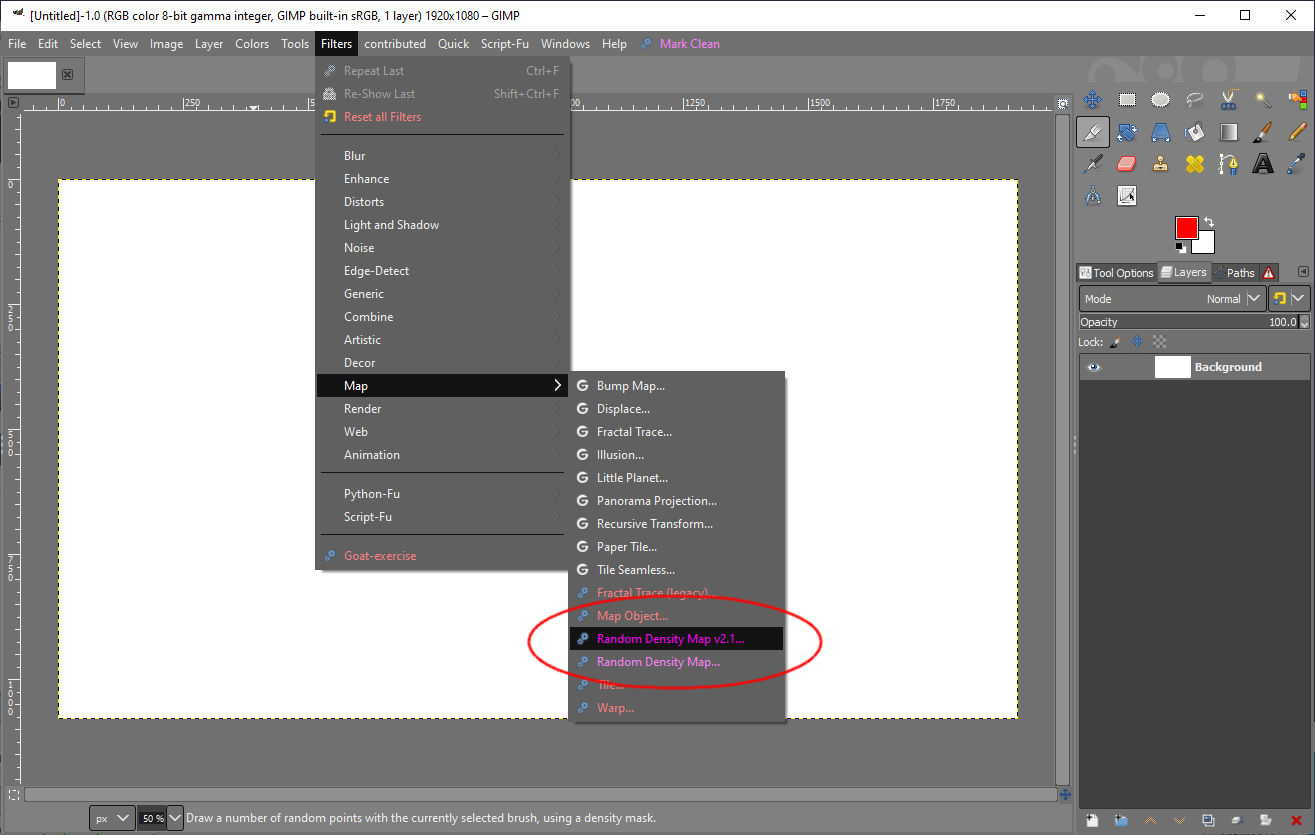

gramp be very careful that you don't have two versions of the script as one will overwrite the other when they are loaded.
BUT as the v2.1 version is effectively a completely different procedure it will register in the menu at /Filters/Map/Random Density Map v2.1... it should be obvious which is which, so you need to check you've put the .scm file in the correct place.

Hi gramp. I downloaded the version V2.1 that you uploaded and it gave me a complete dialog with all the options. There is something is wrong, with either your GIMP or OS, your dialog is different and missing a few options. The script works as it should...
Pocholo, Thank You for subjecting yourself to a completely unproductive exercise to demonstrate this for me!
I have NO idea how either GIMP, or my OS, could have torqued itself into such a state; I fire up GIMP from the command-line and don't see much in the way of complaint when it loads (aside from the complaints that certain 2.x filter conventions spell doom for those filters in 3.x), and nothing helpful when RandomDensityMap fails.

You are using random_density_map.scm version 1 - (any one interested can get it from here: viewtopic.php?f=11&t=530&start=10)
...but the filter you posted is version 2.1 Difference is easily seen in the dialog. Both versions can be installed, they both register individually in /Filters/Map

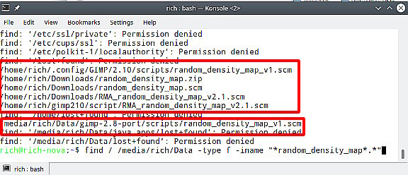

However: Linux is provided with a search function. In a terminal try
find / -type f -iname "*random_density_map*.*"
Which (hopefully) will find the file(s) in your home folder. You might need to expand the search, this for example is my home + a data partition.

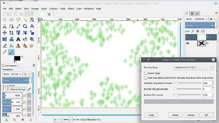

No idea what the margin parameter does. Other than zero gives an error.
