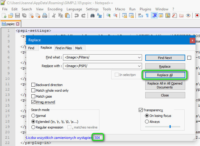

Hi Diego.
Not every user likes to perform such operations. :hehe
This gives you the choice: editing pluginrc or adding a simple plugin.
Your post has mobilized me for another attempt - editing the pspirc file (because I have too many entries from * .8bf files on the Filters menu).
Using Notepad ++ means 5 seconds of editing.
And it works as expected.
