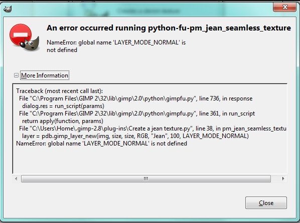

Throws an error. I'm using Gimp 2.8.22. Could this be an issue?

nelo wrote:
Yes, 2.8 is an issue here. The script is written for 2.10.x
Okey-doke. Thanks.
Hi steven8. The arguments for the Layer's mode changed from:
GIMP 2.8
1. NORMAL_MODE
2. GRAIN_MERGE_MODE
3. MULTIPLY_MODE
to
GIMP 2.10
1. LAYER_MODE_NORMAL
2. LAYER_MODE_GRAIN_MERGE
3. LAYER_MODE_MULTIPLY
Also the argument for the fill from FOREGROUND_FILL (GIMP 2.8) to FILL_FOREGROUND (GIMP 2.10)
I made the changes to the 2.8 version and you can download it from the bottom of this reply. Be safe!

Pocholo wrote:
GIMP 2.8
1. NORMAL_MODE
2. GRAIN_MERGE_MODE
3. MULTIPLY_MODE
to
GIMP 2.10
Got it, and it works perfectly. Thank you for going to the trouble of doing this!

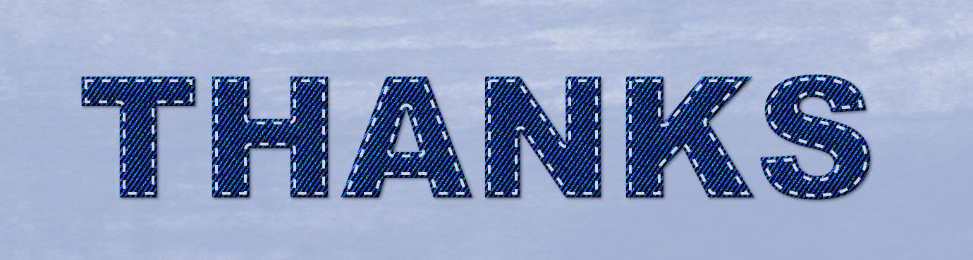

I feel like testing your texture on text. :hehe
I like it!
