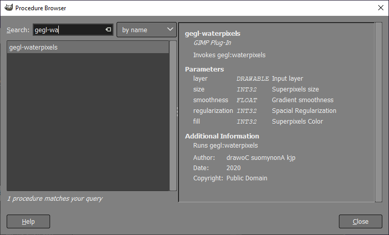

The PDB functions may not exist, but as I said in this thread: viewtopic.php?f=9&t=18040#p247861 it is possible with some effort:
Which others do you want?
