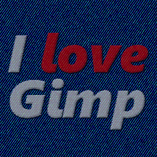

I like that you are still working on the script.
it looks very good
This is made in Gimp 2.8
