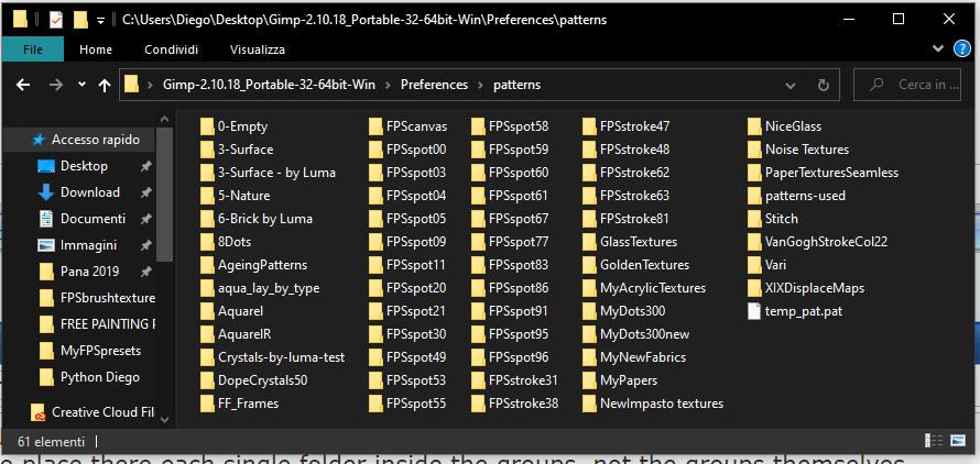

All under user/Preferences/patterns (if you have Ofnuts' ACM: under patterns_storage then activate), but remember:
- you have to place there each single folder which you find inside the groups once unzipped, not the groups themselves.
Have a look at my user/Preferences/patterns folder
