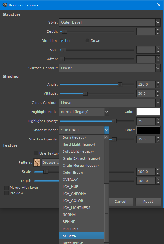

Our colleague Pocholo ran into a problem with using the new layer modes when using layerfx.py
viewtopic.php?f=9&t=18681
This old plugin (but very useful) created by Jonathan Stipe in 2008 - probably due to its length, hasn't been updated with the new layer modes.
This is an experimental attempt to fix this problem.
The new modes are displayed in capital letters for distinction.
Feel free to test (especially people who often use this plugin).
ps. Remember that in some cases, LayerFX in the non-English version of GIMP requires additional gradients?

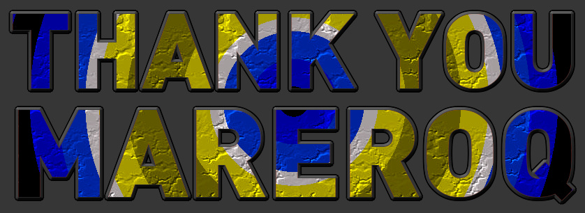

Posts: 1436

Thank you to all the testers.
However, I found an error (when calling from another plugin):
left image undo in inconsistent state, closing open undo groups
6650 lines of code cannot be quickly "repaired" by hand so I also used gimp10_constantize.py by Tin Tran.
As it turned out, for masks, translation is inappropriate for:
ADD_ALPHA_TRANSFER_MASK to ADD_MASK_ALPHA_MASK_TRANSFER and it should be ADD_MASK_ALPHA_TRANSFER
I fixed it.
Sorry for the inconvenience and feel free to test again (although I hope that was the last mistake).
