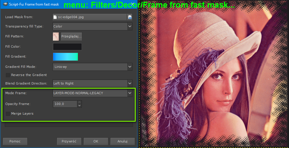

I added for test what you wanted (work on duplicate active layer, layer mode and opacity, optional - merge visible layers) - but I know Grachen will do better.
This version does not conflict with the original Graechan script.

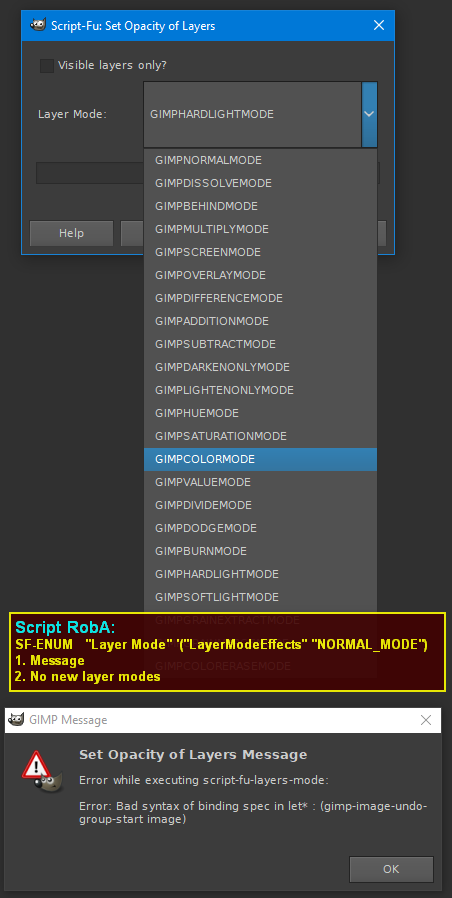

MareroQ have you ever used SF-ENUM "LayerMode" '("LayerModeEffects" "normal-mode") for the layer modes

Hi Graechan.
You uploaded a revision (draft with no recent changes saved?) Without the option to select a layer mode. :roll:
I'm not sure if keeping the layer mask is a good solution (you would have to check if the active layer already has a mask ?).
In terms of
SF-ENUM "Layer Mode" '("LayerModeEffects" "NORMAL_MODE")
very effective solution, but for me it does not work as I would like. :gaah
In my opinion, the level of opacity is more important than the layer modes (as in the Hejian "Rip Border" plug - only color and opacity)
I wonder if the your option "Pattern" "Gradient" can be transferred to border.exe? :geek
ps.As not an coder but a persistent "deprecated procedures hunter":
ADD-COPY-MASK and ADD-SELECTION-MASK this is deprecated! -> ADD-MASK-COPY and ADD-MASK-SELECTION.

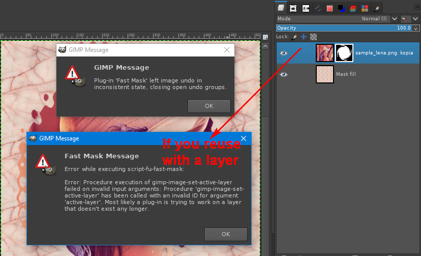

I'll do one and post my error message
Fast Mask Warning
Error while executing script-fu-fast-mask:
Error: ( : 1) Procedure execution of gimp-image-set-active-layer failed on invalid input arguments: Procedure 'gimp-image-set-active-layer' has been called with an invalid ID for argument 'active-layer'. Most likely a plug-in is trying to work on a layer that doesn't exist any longer.
GIMP Warning
Plug-in 'Fast Mask' left image undo in inconsistent state, closing open undo groups.
I used an image that I use for everything else

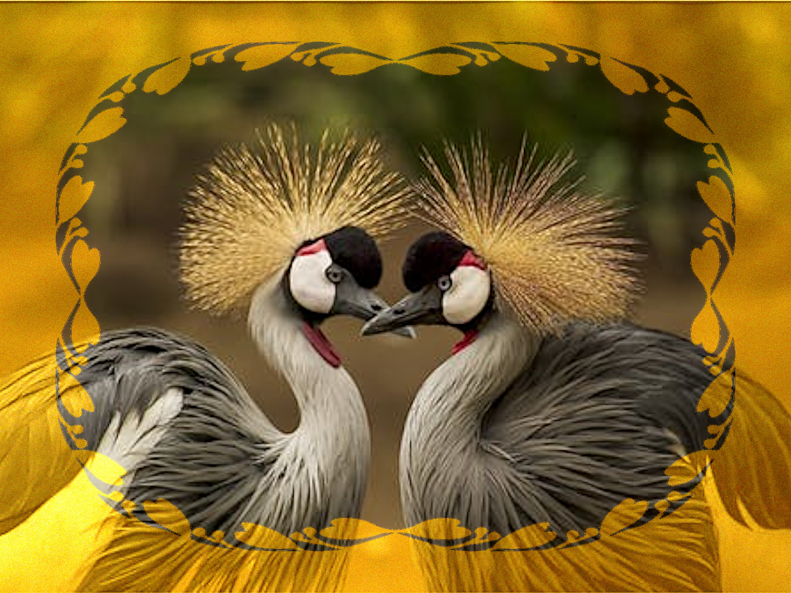

I find it very nice and quick to get a nice decoration on a pic. I like it a lot. Thank you MareroQ. :tyspin :yes

You showed Sallyanne's error message earlier, and it's because you have the layer-mask selected:

It is possible that it is - but we do not know if the script even allowed to create a layer mask?
