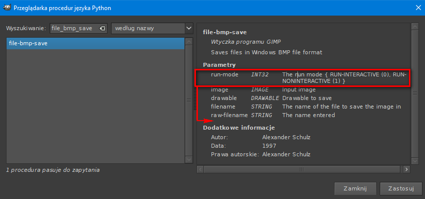

The number of parameters does not match
pdb.file_bmp_save(image, drawable, "c:\\testa.bmp", "c:\\testa.bmp", run_mode=RUN_INTERACTIVE)

Thanks Marero.
Is this documented somewhere? Or is there a rule like "interactive always must be named parameter" or ???
I would never have figured this out!
After getting it working, I found that file_bmp_save command prompts for the bmp save options (Run-Length encoded, etc.) but doesn't prompt the user for filename.
Do you know if this is possible?
