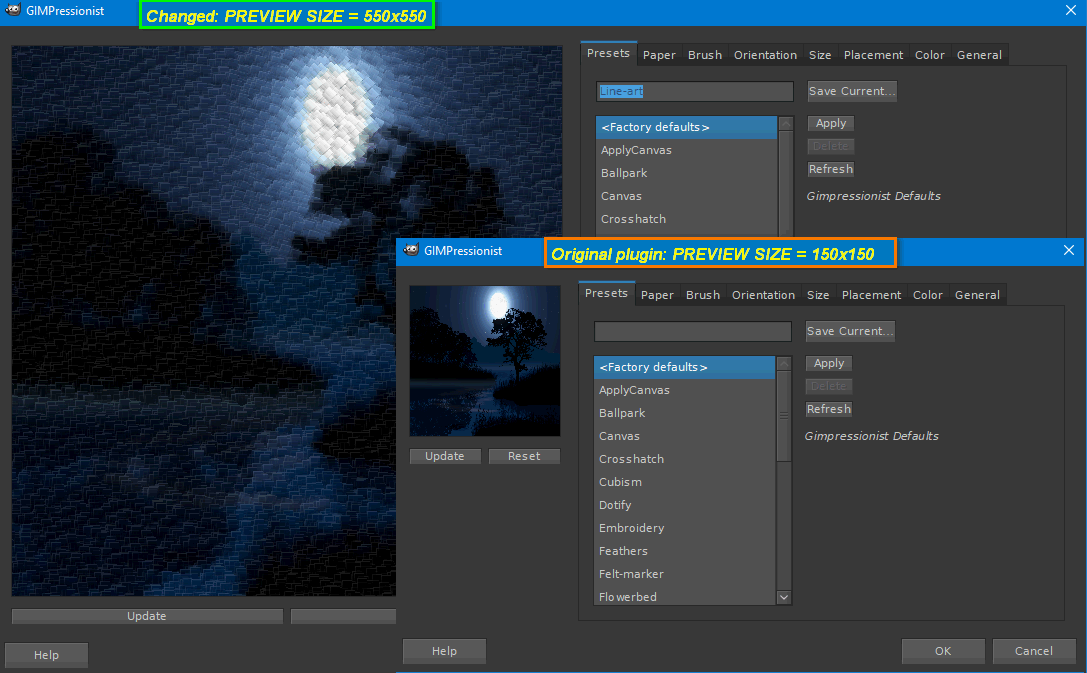

Onkel Hatti compiled larger preview Gimpressionist for Gimp-2.7.5 (23/03/2012) - but without giving the patch.
viewtopic.php?f=9&t=3876#p48314
My solution:
In file gimpressionist.h (line 33)
replace:
#define PREVIEWSIZE     150
to:
#define PREVIEWSIZE     550
Very easy once you know the way... :hehe
Gimpressionist- Big Preview - Ubuntu 20.04_64bit.zip [268.55 KiB]
Downloaded 213 times
Gimpressionist-Big Preview-Windows_64bit.zip [163.77 KiB]
Downloaded 290 times

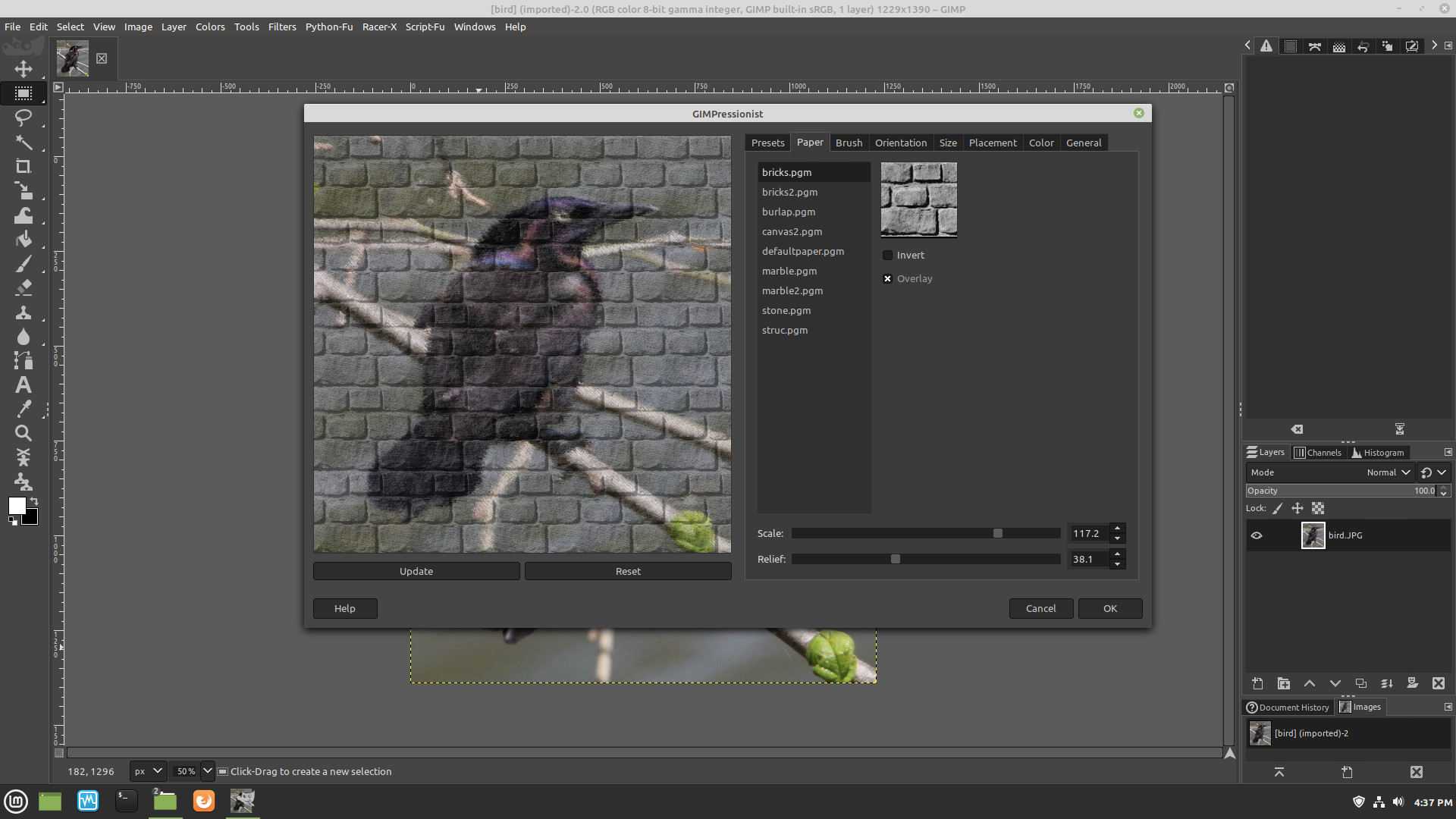

OK, can confirm it works in LM-20 Cinnamon (based on Ubunto 20.04) running AppImage. It will not run in MX-Linux 19.2 (based on Debian Buster 10), even while running AppImage.

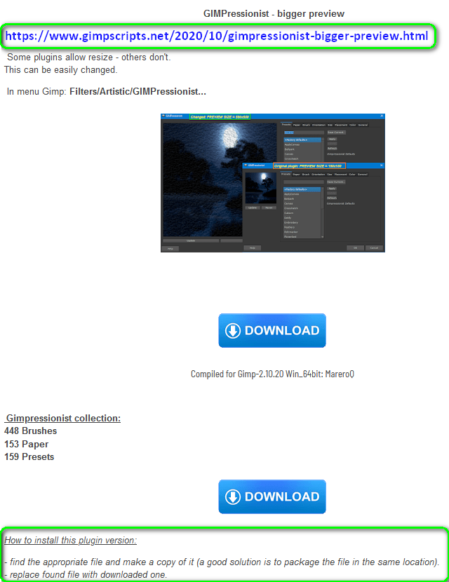

How is this version installed? There should be a how to on gimpscripts.net

@Graechan
These were plans that were never realized.
The development of gimp-fretype ended with version 0.6 (16 years ago).
A simple description of the change from: Switch from GtkEntry to GtkText requires a lot of code changes.
This change is simple for python-fu or script-fu - but not for "c" (a different datatype at least).
If someone changes this code I would like to try to compile.
The manual solution to the problem of multiple lines was well described by Paul Sherman:
https://www.gimphelp.org/freetype.html
@Mackenzieh
I don't understand Your post.
Is this not sufficient instruction for You?
