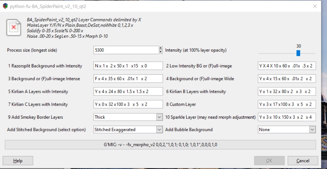

You can try this version.
I only tested for Gimp 2.10.18, G'mic 2.8.4.
Just beware - as Nidhogg wrote, it is possible that some combinations of parameters give errors (this is a slow plugin and I haven't tested many combinations).
I've made 70 corrections - maybe more will be needed. :cool
Older version removed.
You can download from here:
viewtopic.php?f=9&t=18138#p248848

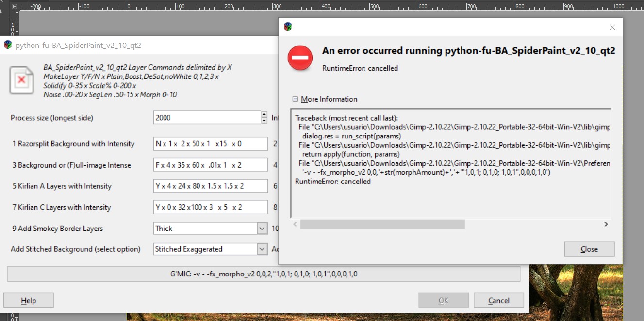

PostPosted: Tue Nov 24, 2020 9:47 am  (#16)
Posts: 14162
MareroQ.

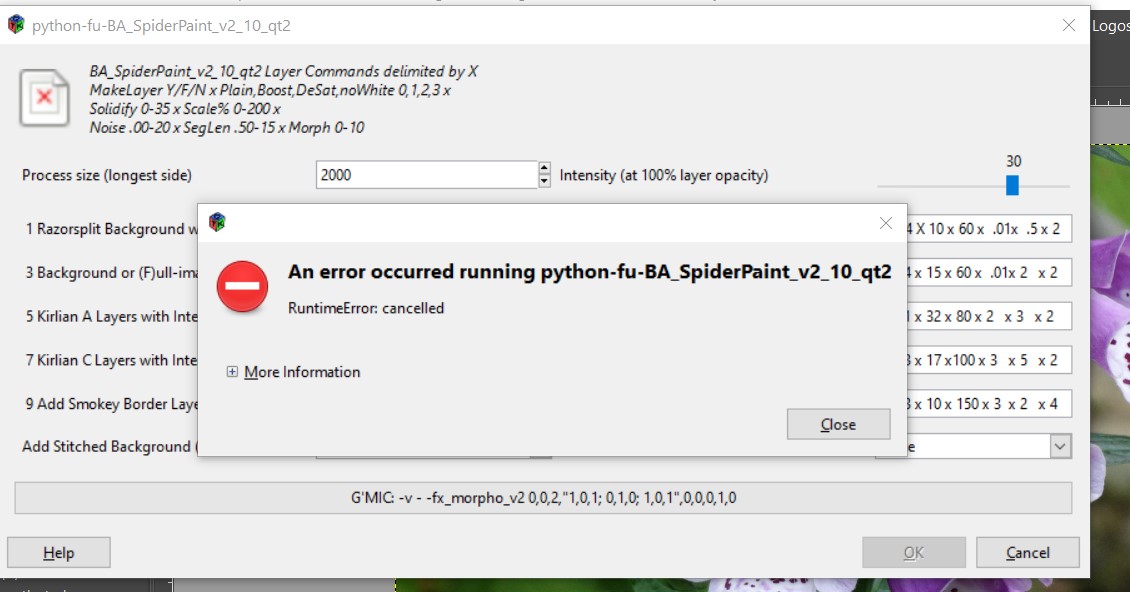

BA_Spider Paint stops at that point (see the shot)
I'm sure the image has an alpha channel. What can it be?

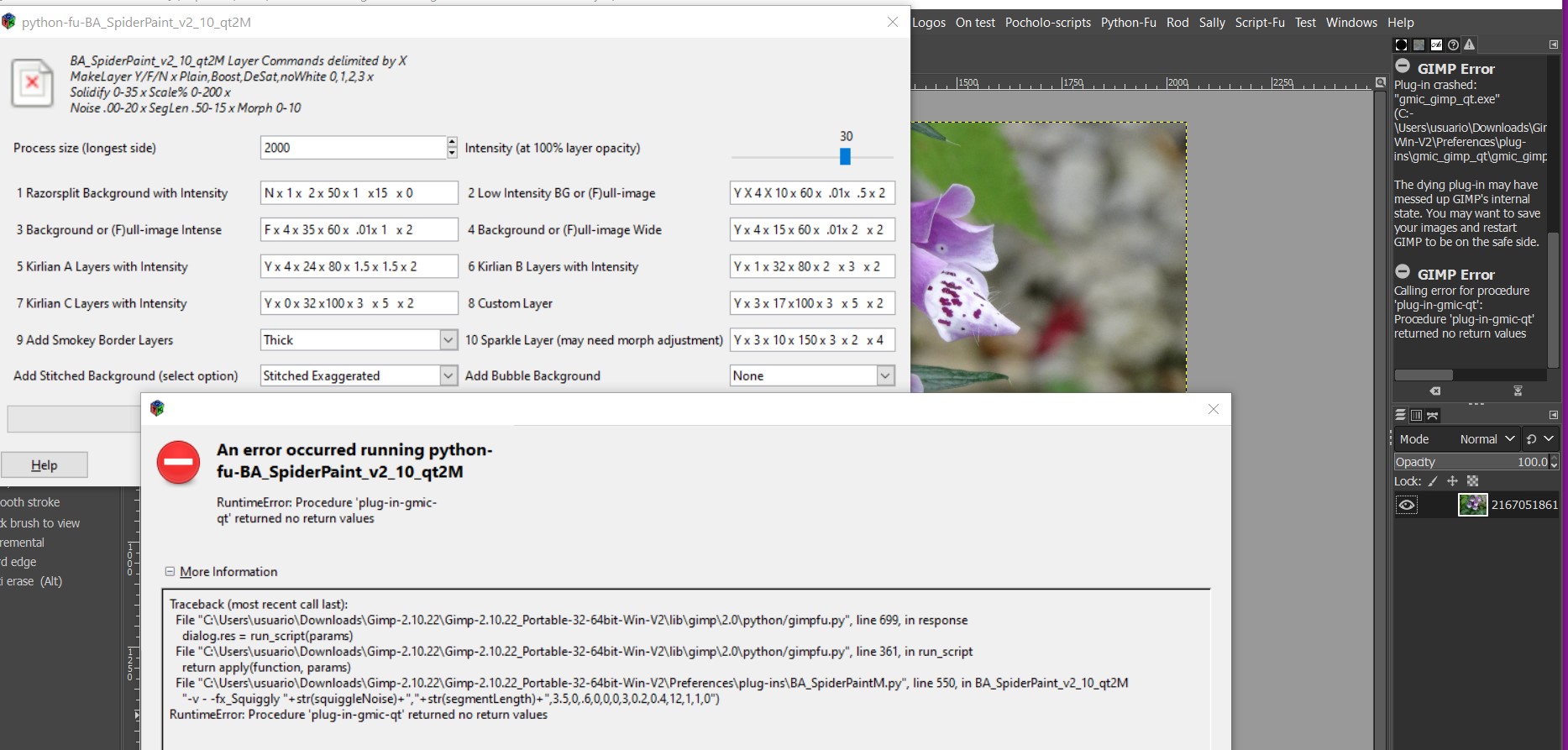

Thank you so much for your attention.
Screenshot 2020-11-24 153819_Stops_Here_SpiderPaint.jpg [ 123.21 KiB | Viewed 6540 times ]

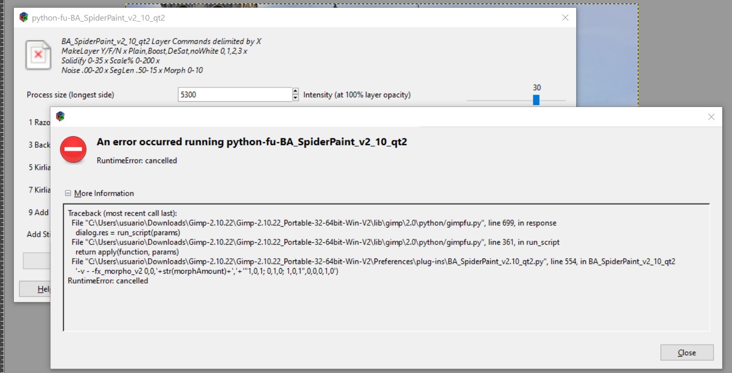

 Post subject: Re: Gimp Filter BA_SpiderPaint
PostPosted: Wed Nov 25, 2020 10:49 am  (#18)
Posts: 14162
Thank you so much MareroQ, but the problem continues.
I don't get to make Spider Paint work. any of the two versions.
About gimpfu. Yes, I tried the newer version and I had many problems. it affected to BRL logos.

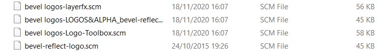

PostPosted: Wed Nov 25, 2020 11:44 am  (#19)
The command name has changed in G'mic.
Can You try again?
BRL = Bevel-Reflect-Logo.scm?
More details (because these are two separate things - gimpfu.py only affects python plugins and only script-fu.exe for scripts).
PostPosted: Wed Nov 25, 2020 12:00 pm  (#20)
Posts: 14162
I have those items you say.
What must I change?
