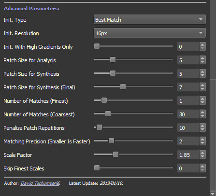

Is not working. What I noticed, the preview windows shows very cryptic pictures, e. g. like an icon which you scaled up to 200 x 200 pixel or an small band. Enclosed my settings (I used it some hundret times without trouble). There is no selection active!
If I could start the tool, my PC freeze after 34 sconds. Switch off is than the solution only. :roll:
File comment: my Layers
File comment: Setting #2
File comment: Setting #1

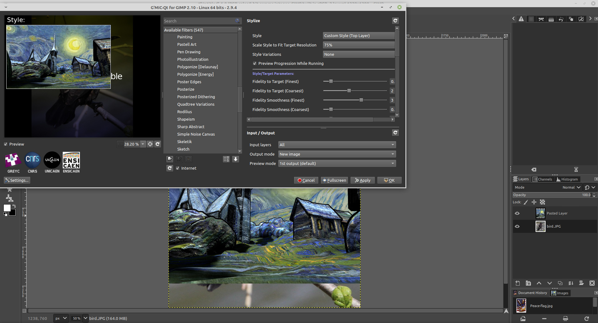

Maybe you have too many layers, try with just 2 layers. It works fine here.
